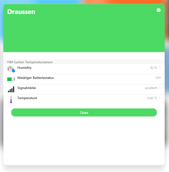

The new invention “Card at-a-glance badges” does not work on my openhabian setup for some reason. It should work by using the semantic model only. Not in my case:
and:
Shouldn’t it show temperature and humidity?
Here the setup:
I also tried to select temperature and humidity:
It should display all if none are selected. Both options did not give me the desired result.
Any ideas?

Could you please post your semantic model tags, you set for each item in your “Draussen” card (“HM Garten Temperatursensor”-group, “Humidity”-item and “Temperature”-item)?
Maybe you can fix it with these infos !

Hey Dave,
thank you! I figured it out: Wrong tags!
and
It is that easy, if you now where to look…
