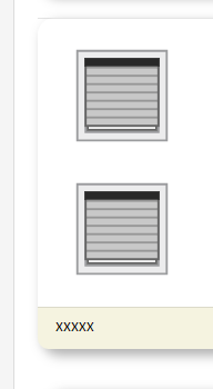

I have a widget with card footer (yellow) :
on the PC, it looks ok and tiny, but on the cell phone is this footer too wide.
my code is :

but decrease height value from 9.5 to let say 5 doesn’t have any efect.
Any idea how to make it more tiny on the cell phone ?

Device object is working correctly, because I can also see influence if I will increase a value (depends on if it’s for desktop or cell phone).
But decreasing has a lower limit which on the cell phone is still too wide. On the desktop it’s ok.
Ah, now I understand. Yes, the footer has a minimum height that is set by the f7 variable --f7-card-footer-min-height.
If you cannot reduce the footer beyond a certain height then you are running up against that limit and you will also have to change that value. Rather than work out something different, you should be able to just use the same expression you are using for height or you can just set it to something you know wil always be smaller than your height value such as 1px.
height: =(device.desktop)?('2.5vw'):('9.5vw')
--f7-card-footer-min-height: 1px
That value is there for a reason, so if you lower it and then reduce your footer height too far, you will likely wind up with some strange visual results that will also require further style fixes.
Yep, this is solution of my problem.
