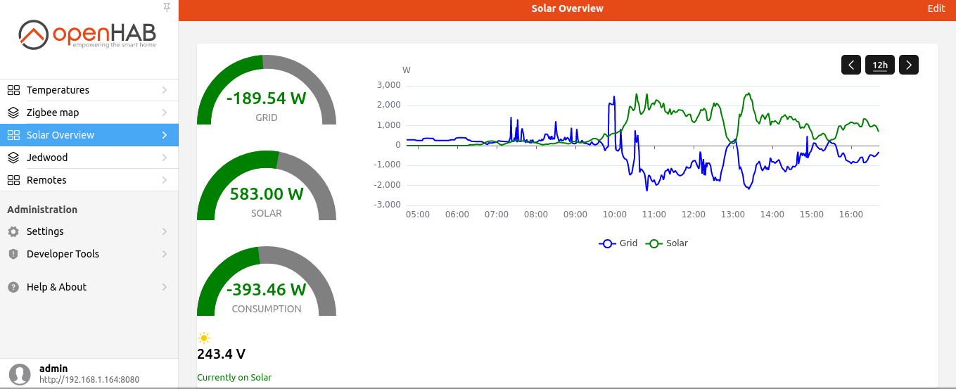

catt -d “Greg chromcast” cast_site http://192.168.1.164:8080/page/Solar_Overview
The screen on the TV shows like this:

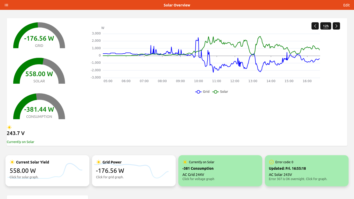

But I would like it to look like this:
Is there a way to do this?

The only way I have found is to cast the screen to the device and then press the small pin icon to remove the side menu.
Then I stop the casting and when it gets cast again it seems to “remember” the setting so it displays full screen.

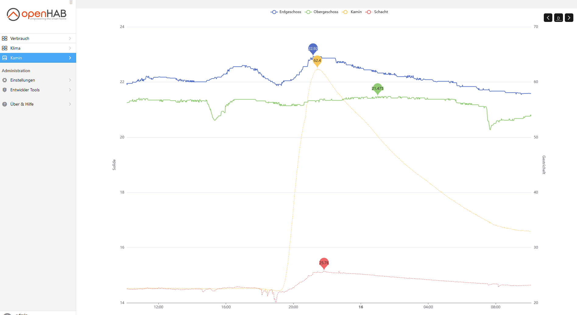

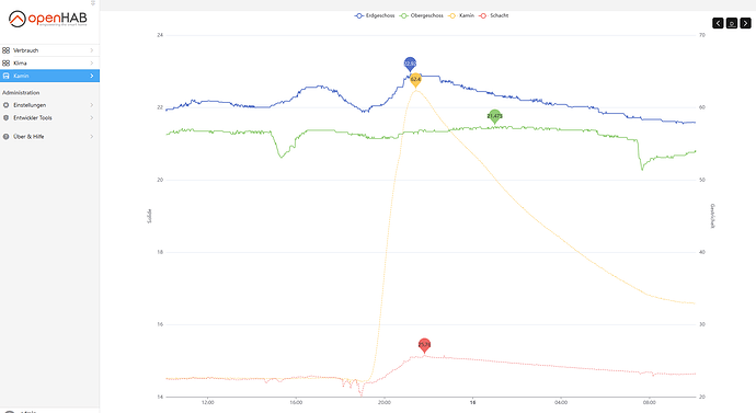

I’m not sure, if I should open a new topic, but let me try here.
Casting works perfectly.
Is there a way to hide the navbar (top) and sidebar (at the side) using URL parameters? I want to view the page on my PC with the bars, but my TV has no mouse or anything… I could not find anything, so I have little hope…
https://openhab/page/kamin_und_rooms?XXX=XXX
