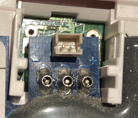

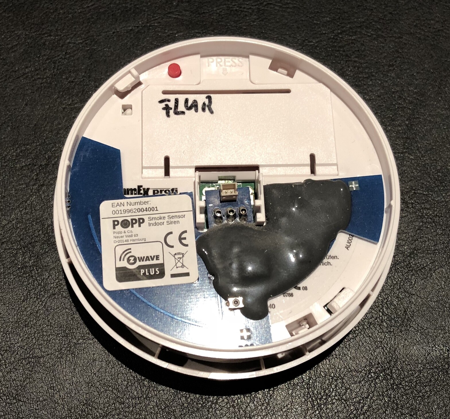

Now all I need is a suitable jumper for the connection in the smoke detector itself. Can anyone help? Does a photo of the smoke detector help?
Thank you very much for your support.
Yes please, photos of the outside and opened up.
With a zoom in on where the normal power would be connected
Oohhhh, fun. I love these kind of hack…
Ok, will post pictures tomorrow. lucky for me that you enjoy such hacks
I love the problem solving challenge. And there is always something new to learn.

![20180929_184029849_iOS|540x500]
I have three of these smoke detectors in use. Per floor (cellar, ground floor, 1st floor) one. On the 1st floor more will be added.
I have already turned off the meshing according to the instructions. The interval for communication with the controller should be set to 3h. Currently my default value for battery-operated Z-Wave devices.
As far as I know, the power supply supports the Z-Wave function and has nothing to do with the operation of the smoke detector. But I will order an original power supply and test it with the smoke detector that is mounted closest to the server cabinet. This is the shortest distance. The solution with the intermediate patch field also allows me to test the further distance. Then I can still decide if I want to use an adjustable power supply or if the standard power supply is sufficient.
