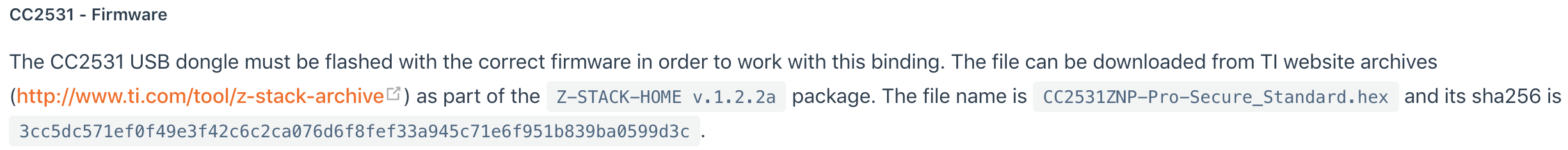

I have a general question concerning the CC2531 and IKEA Tradfri. I am using the CC2531 without mqtt, I flashed it with the follwoing software:
and added then the CC2531 directly to openHAB. It works perfectly with some china ZigBee devices like LED Controllers. Now I try to add a Ikea Tradfri Smart-Plug but openhab can’t find it. I already read about the problems with the IKEA bridge, but I can’t find any debugging with using only the CC2531 WITHOUT MQTT.
