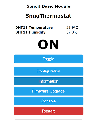

Hi Jacek,
If you are thinking of updating an old wall thermostat then you could use a sonoff basic with a built-in DHT22 temp sensor. Sonoff basics have 4 spare gpio pins on the board that lets you add a temp sensor. It’s super easy to set up, I have 12 of these running my underfloor heating. You don’t need to add relays near the underfloor heating actuators as the sonoff basic is the relay thermostat. With a simple rule, you can set your room temperature setpoint to 21c, when it goes below it turns on, and above it turns off. I flashed the sonoff with tasmota and connected it to OH via MQTT.
All this can be done for very cheap and it’s faultless.
