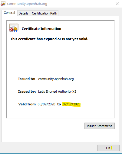

not causing much grief except KIS is complaining every time i open a email from the community

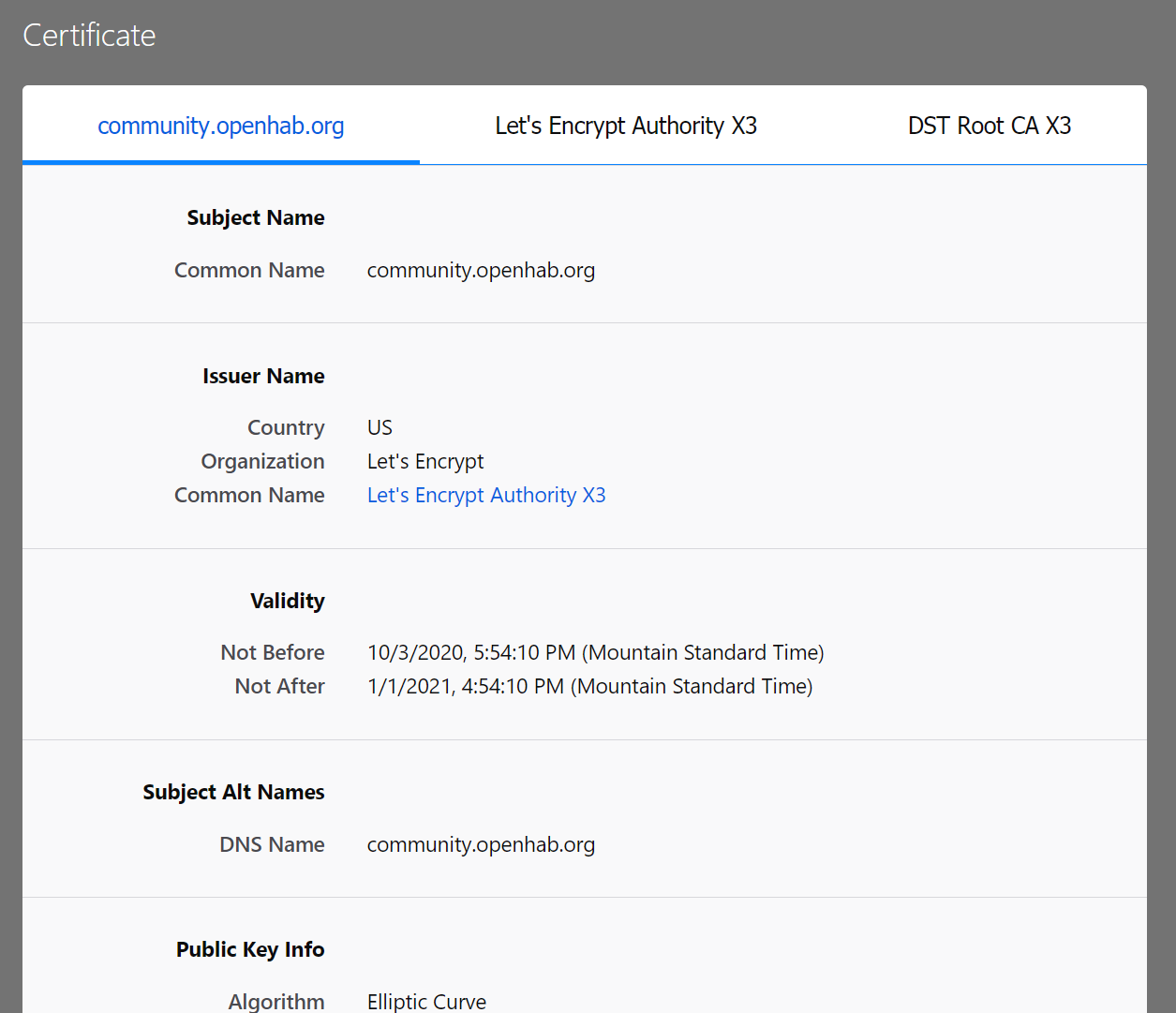

It’s showing an expiration date of 1/1/2021 for me.
Most browsers won’t even let you bring up a web page with an expired certificate.
There is definitely something up…

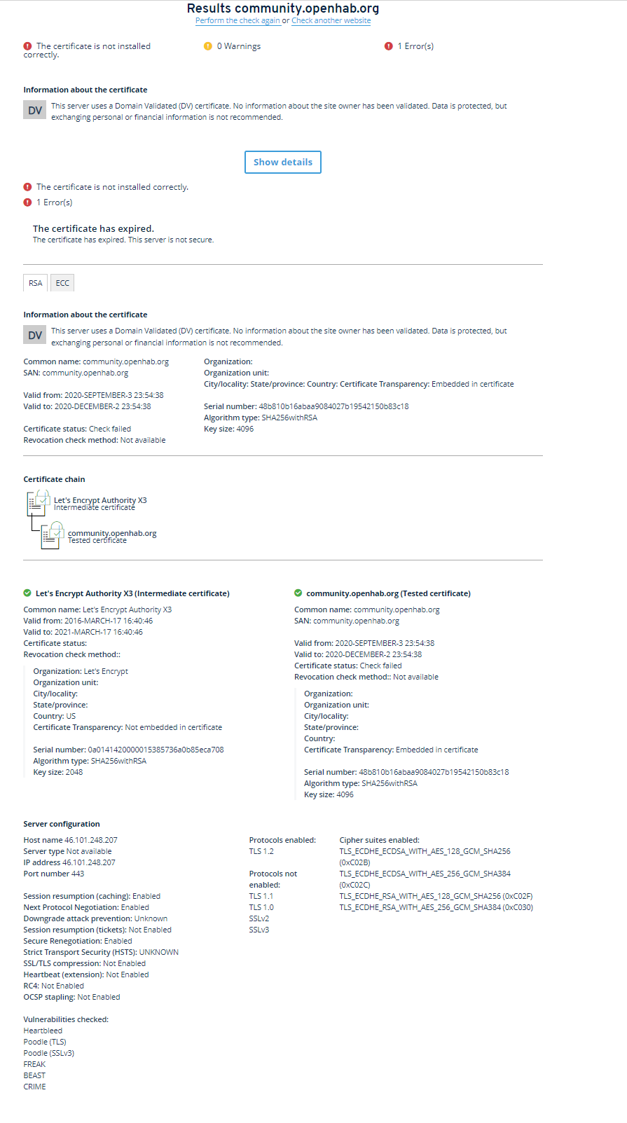

running a check at SSL Checker | Free online SSL Certificate Test for your website | IONOS shows the intermediate ok, but the server cert as expired.
As far I see on SSL Server Test: community.openhab.org (Powered by Qualys SSL Labs)
the server hosts two certificates and one of them is expired.
@digitaldan do you maintain the serves certificates ?
I assume the second ( expired ) certificate was used during transition period of the new certificate.
Shouldn’t it be removed ?
