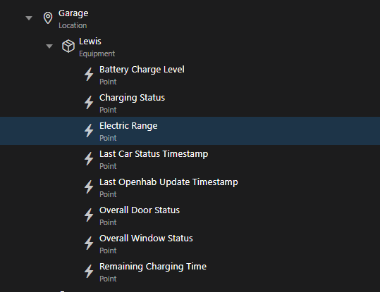

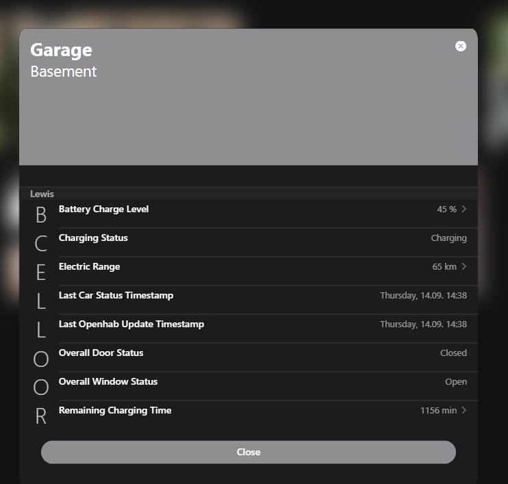

On the Location card for the Garage I have a Point
Still displays km
I’ve confirmed that Pattern is present on that Item.
There is no Category or Semantic Property for that Item, but that should not matter, correct?

Actually got something working.
With a State Description Pattern of %.1f mi it should show the value in miles on the location card.
The Pattern was different in your last reply.
%.1f mi. at least it now displays miles but doesn’t convert the number.
