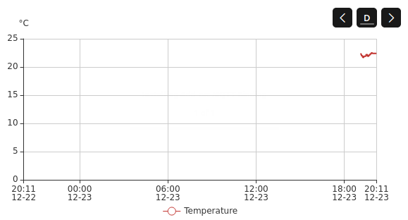

Is there a way to change the date format on the x-axis of the Analyse Charts?
At the moment it seems to be formatted month-day, which is awfully American…
I wondered whether it had something to do with Regional Settings, but these are correct for my area, where we would usually use day-month-year

Did you ever find a fix for this ?
Nope, but then I’m still on OH2 for my production system so I haven’t tried looking any further…

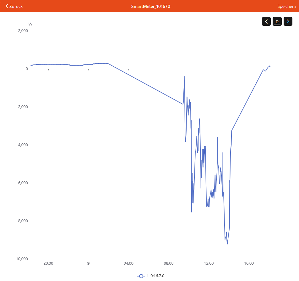

I’m on OH3 (Snapshot #2206 ) and my analysis chart looks like that:

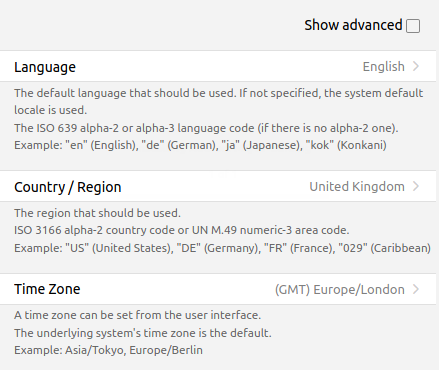

I’m using a German language setting, changing it to UK English didn’t show to date as in the OP either.
Strange. I’m on the 3.0.1 Release Build.
runtimeInfo:
version: 3.0.1
buildString: Release Build
locale: en_GB
Analyse charts still have US date formatting.
If I run locale in a terminal on my OH3 device:
LANG=en_GB.UTF-8
LANGUAGE=en_GB:en
LC_CTYPE="en_GB.UTF-8"
LC_NUMERIC="en_GB.UTF-8"
LC_TIME="en_GB.UTF-8"
LC_COLLATE="en_GB.UTF-8"
LC_MONETARY="en_GB.UTF-8"
LC_MESSAGES="en_GB.UTF-8"
LC_PAPER="en_GB.UTF-8"
LC_NAME="en_GB.UTF-8"
LC_ADDRESS="en_GB.UTF-8"
LC_TELEPHONE="en_GB.UTF-8"
LC_MEASUREMENT="en_GB.UTF-8"
LC_IDENTIFICATION="en_GB.UTF-8"
LC_ALL=
Which all seems correct? Not sure what else to look at.
