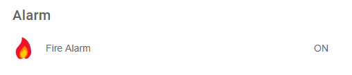

Is it possible to change the icon (e.g light bulb) based on the state when using a with a item String i can do this when i set a item as a switch?
i currently have a ESP8266 set up to read the sate of a smoke alarm. and sends back either 1 or 0 depending on if the alarm i activated. if i set the item as a switch the icon charges depending on the state however it will on show ON or OFF in the BasicUI and i would prefer it to have say CLEAR OR FIRE DETECTED i can do this setting the item as a string but can achieve both at the same time. when setting the item as a string the icon wont change. can i get the best of both woulds or not?
i am using a map to change the 1 or 0 sent by the ESP to openhab to CLEAR OR FIRE DETECTED.

if i have it as a switch as below
Switch   F2_Fire       "Fire Alarm [%s] "            <Fire>         (gAlarm)          {mqtt="<[mqttoh2:/Alarm/fire/fire:state:MAP(test.map)],
<[mqttoh2:/Alarm/fire/fire:command:ON:1.00],<[mqttoh2:/Alarm/fire/fire:command:OFF:0.00]"}

for it to work but i would like to change the ON/OFF to CLEAR OR FIRE DETECTED but when i do this openhab stops show the right State
can you tell me where am i going wrong please
You need two maps. One that you use on the binding like you are now and another you use in the label. See the transformations link provided above.

I think what you want is this.
Switch   F2_Fire       "Fire Alarm [MAP(test2.map)] "            <Fire>         (gAlarm)          {mqtt="<[mqttoh2:/Alarm/fire/fire:state:MAP(test.map)],
test2.map
ON=FIRE DETECTED
OFF=CLEAR
Thank you, have got it working
Yeah sorry I forgot its [MAP(test2.map):%s]
