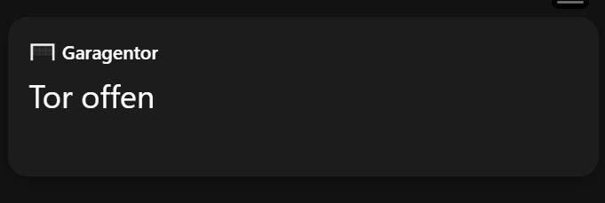

Next Problem:
component: oh-label-cell
item: KGGarageTorZushelly1483fdaa23555100100101_Eingang
label: '=(items.KGGarageTorZushelly1483fdaa23555100100101_Eingang.state == ON) ?
"Tor geschlossen" : "Tor offen"'
color: '=(items.KGGarageTorZushelly1483fdaa23555100100101_Eingang.state == ON)
? "green" : "red"'
icon: oh:GarageDoor
header: Garagentor
slots: null
The label works fine, the color not.
I want the cell to get green if garagedoor is closed and red if garagedoor is opened.
The backgroud is always black:
JustinG
(JustinG)
June 12, 2022, 2:50pm
7
Label cells only use the color
property to set the background color if the on
property is set to true
