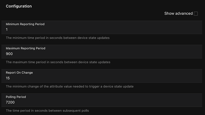

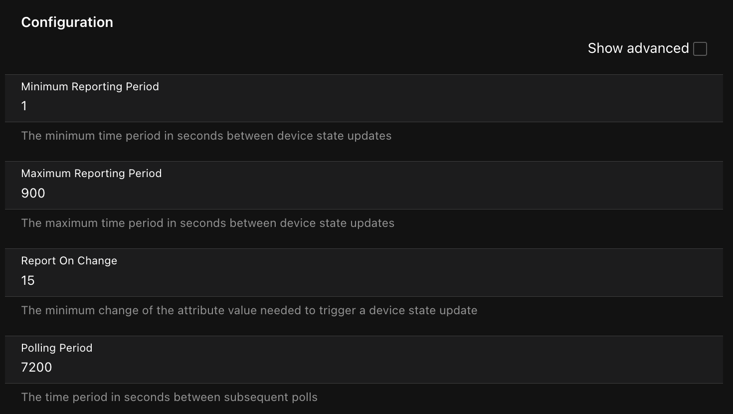

See the configuration below for a standard channel -:
It’s possibl that if the binding doesnt get confirmation of the reporting update, that it doesn’t update these values - I dont recall now (I wrote this many years ago :slight_smile: )

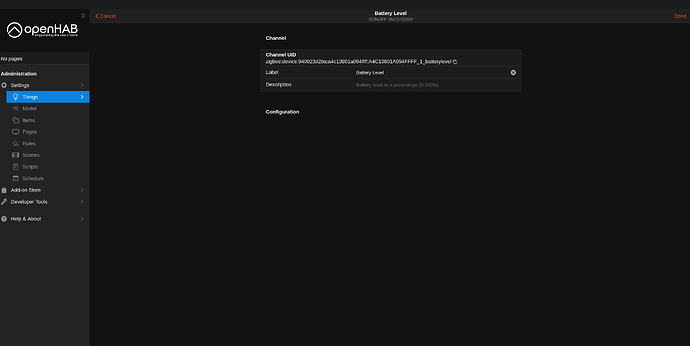

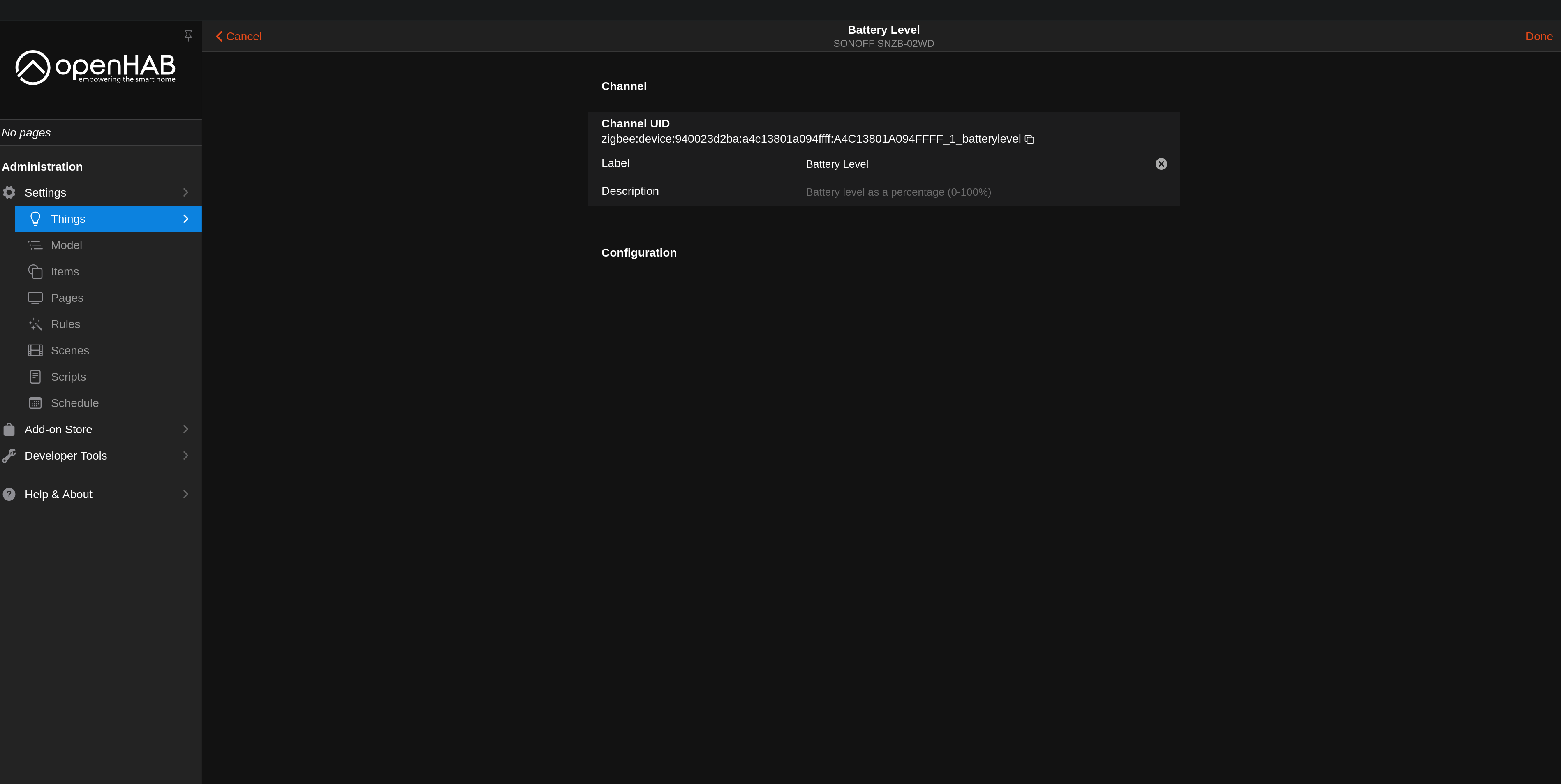

Thank you for the detailed explanation. I see an empty page there (openhab 4.3.9):
The page is empty even for Zigbee devices, which do support polling. For non-polled devices, this page shows the line “This channel has no configuration“. Could you tell me, please, how did you get to that pretty menu? Thanks.
