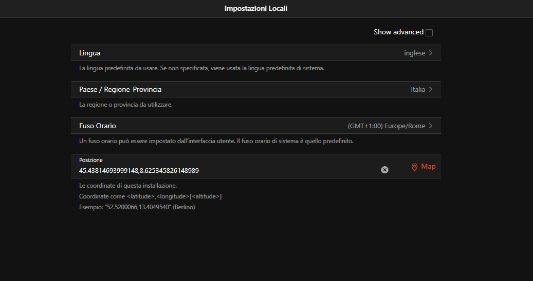

I setup Language to English:

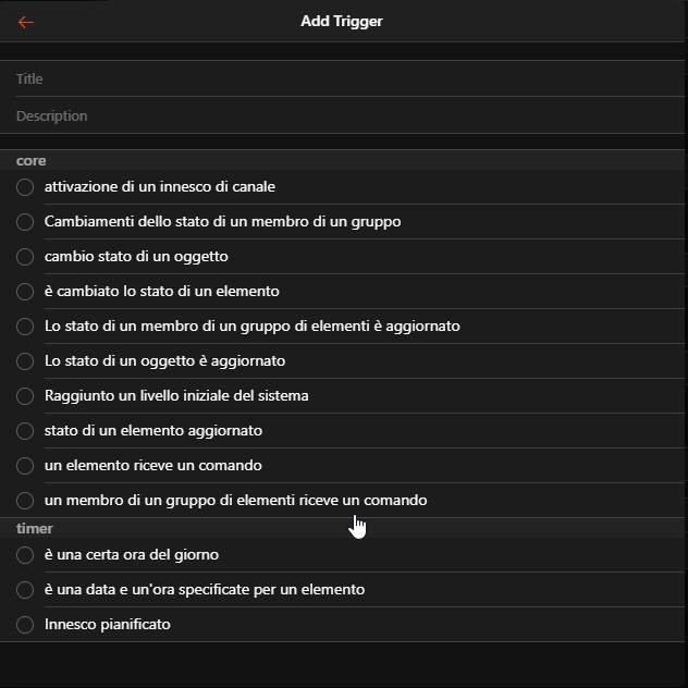

But in some place, all is still translated to italian, here is when I create a rule:
Translation in italian is very good, but I prefer to have all in english

2023-02-08 21:26:33.281	INFO 	.core.internal.i18n.I18nProviderImpl	Locale set to 'en_IT'.
Why en_IT ?
en is the language setting, while IT is the regional setting, affecting e.g. date formats etc.
