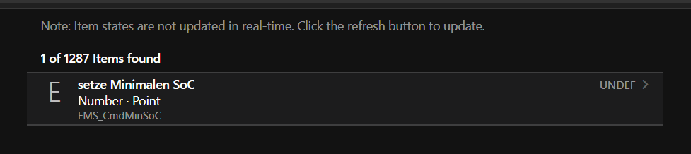

My expectation would be to get the exact state I get, when I ask via UI/API:
http://192.168.78.20:8080/rest/items/EMS_CmdMinSoC/state
Response body
UNDEF
