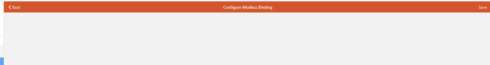

I haven’t found a possiblity yet to undo this, since the binding configuration page is blank now.
