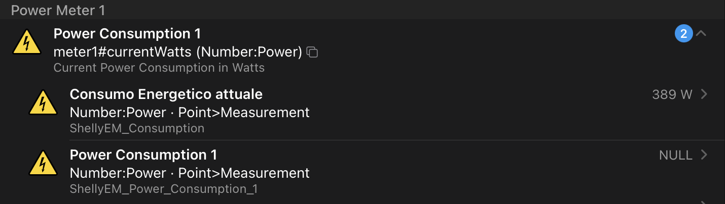

As you see in this screenshot the first item is the “direct” thing->item, the second one with NULL value is with profile JS(|Quantity(input).multiply(Quantity(‘-1 W’))). Channel in the first item is updating, not in the second one. I’ll try to do a .js file but from the examples I only see String inputs, does it support also Number inputs?
You’ll have to parse the String in the transform.
Can you take a screenshot of your item profile configuration?
I suspect it is: JS(|Quantity(input).multiply(Quantity('-1 W')))
