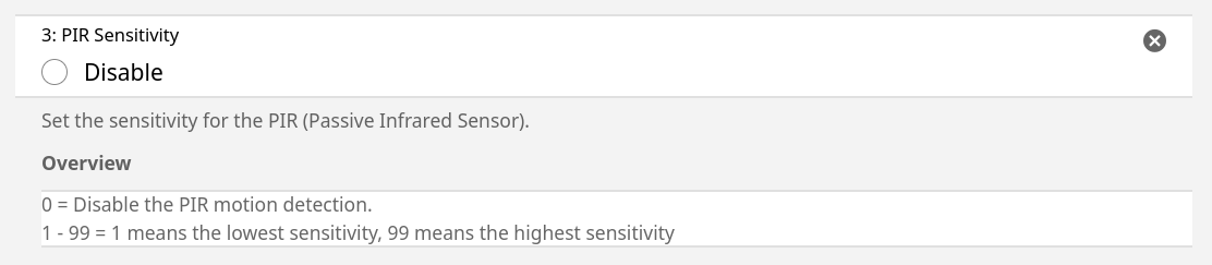

In the thing window I have as an example for parameter 3 of the motion sensor (PIR Sensitivity) only a disable button (0) but no field to change the value (e.g. to 20, default is 80).

In the thing tab I have only a button to disable? That seems to work.

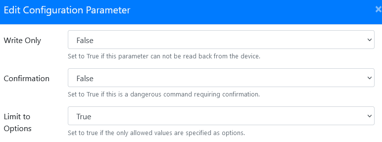

You cannot change the PIR sensitiviy because param #3 is Limited to Options:
Please read
https://opensmarthouse.org/blog/
create an account, ask @chris for write access and correct the wrong entries in the Z-Wave database, request a review, wait for approval, install latest Z-Wave snapshot.
