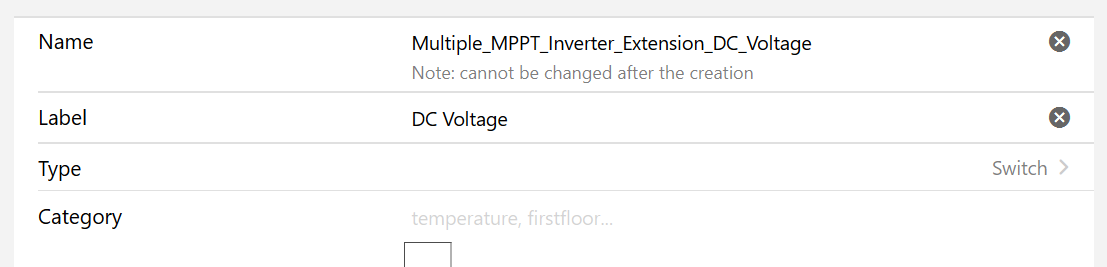

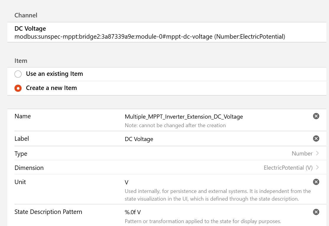

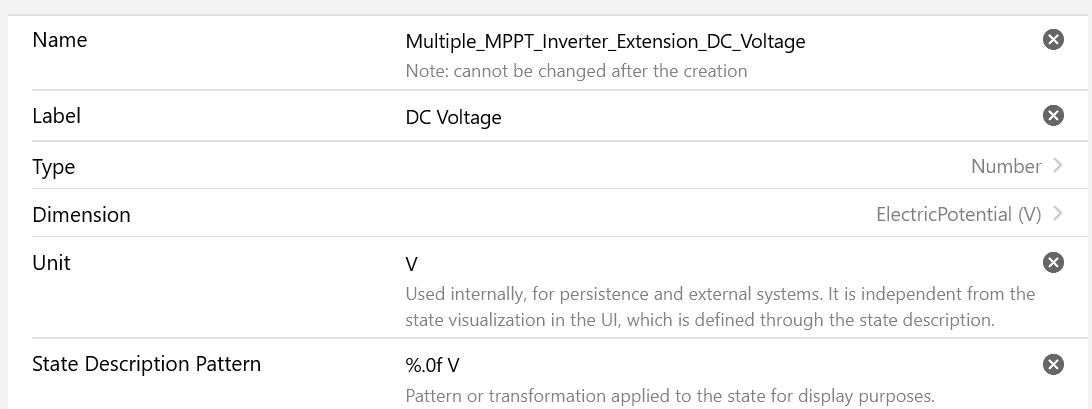

If I link a channel, that was defined in the XML file, to a new item, openHab populates “Type”, “Dimension” and “State Description Pattern” of the item with the proper values from the XML file.

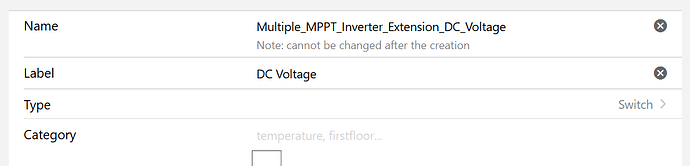

If I do the same on a channel, that was created at runtime via editThing()
, openHab tries to create a “Switch” item instead of “Number:ElectricPotential” and the state pattern also stays empty.
What confuses me, is that both channels use the same ChannelType. And openHab reads the “label” from the ChannelType, but not the other information.

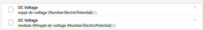

The upper channel is from the XML file, the lower created by the code above:
Linking the first one the a new item:
Linking the second one to a new item:
What am I missing?
