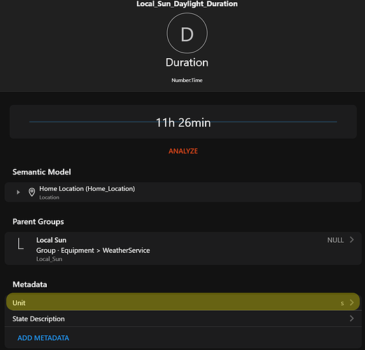

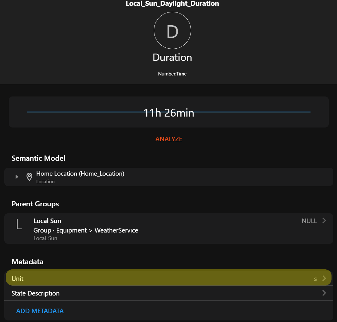

So in UI search your item and open it. Click on Add Metadata and select State Description.
In the pattern add the wanted conversion.
Like in the picture below Unit is seconds and is converted into hour and minutes with
%1$tHh %1$tMmin

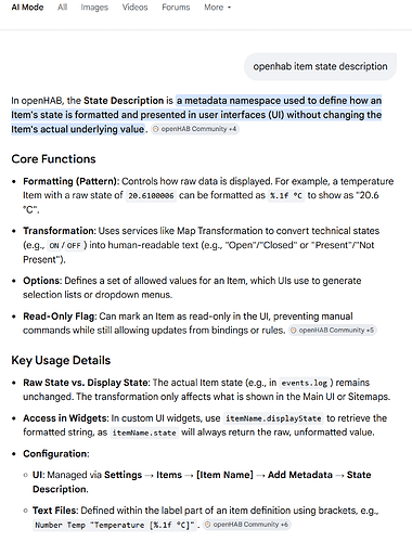

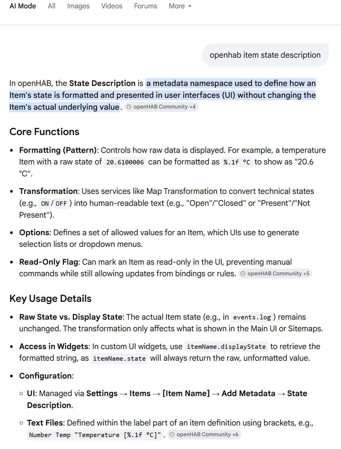

My advise: use AI search
If you know the bingo word which is here state description you’ll get a comprehensive answer combined from openhab docs and community posts. Also the UI config is mentioned!
