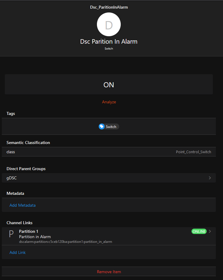

I am linking a Switch item to my DSC partition channel, in my OH3 setup. After doing so, there is no longer a switch toggle in the item UI?

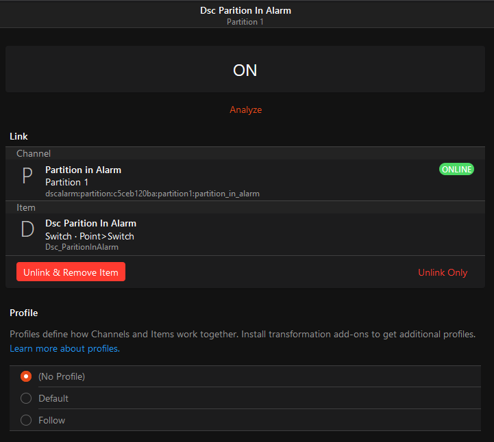

Here is the Channel:
It make sense that it’s read only in this application. However, I would like to test out some rules based on this item. So without the ability to manually setting it, it would be difficult to test rules.
The only way it seems is to use API. As it shown on the second picture, I was able to manually set the state to ON via API.
Is there a way to manually disable this ready only and bring the toggle back temporarily?
Thanks,
Joe

It’s off, has always been off. First thing I checked.
