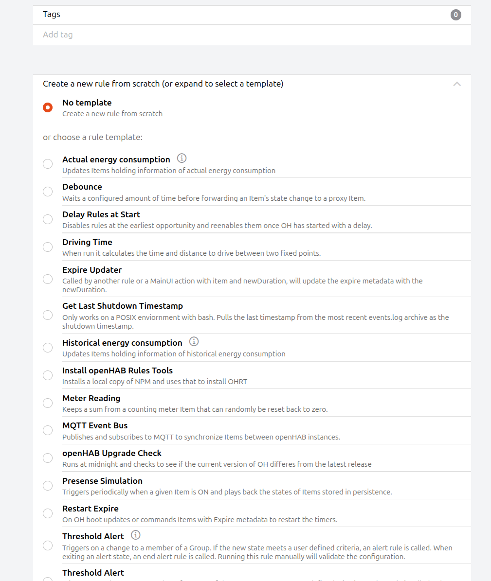

Yes, it’ll need it’s own category. I can’t see these going anywhere in the existing categories. And we should try to support defining more than one Thing per posting. That works for rule templates now so I don’t think it’ll be too hard for Thing templates.

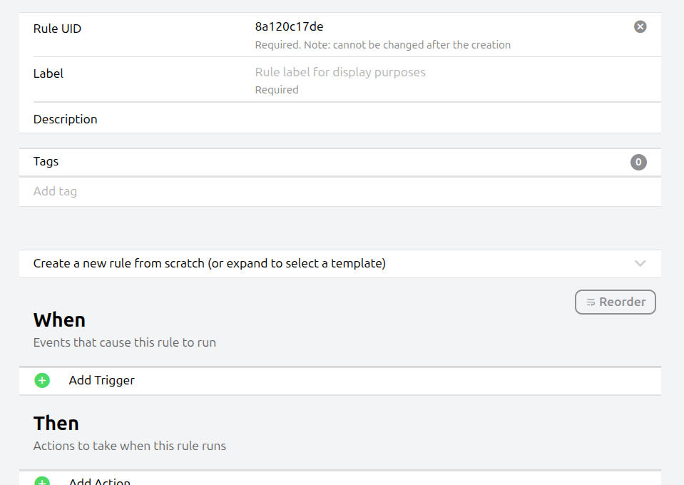

I like how rule templates work now with the list of installed templates collapsed by default. But you can click through to get the list.

For installation, to be consistent with widgets, block libraries, and rule templates there would be a new section under the bindings category in the Add-on store. That’s where you would browse, add or remove the tempaltes.

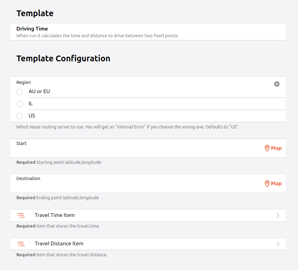

Completely filled out for you, and the custom parts are asked for in a parameter.
Same as for rule templates and widgets.
See Parameter Playground for a mostly comprehensive example of all we can do with configDescription parameters.
Those with “Map” actually bring up a map to select a location.
The Item selectors only bring up a list of Items of the defined type.

The way it is for rule templates is that you Ctrl+click the “template badge” to automatically select all rules that use that template. Then you just press “Regenerate”. There is no “automatic warning” that the currently installed version of the rule template is different from the version you used to generate the rule, because - they aren’t versioned.
