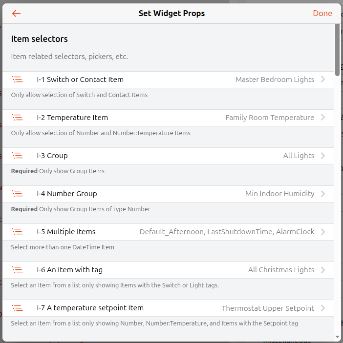

Then Navigate to MainUI → Developer Tools → UI Widgets → parameterPlayground.

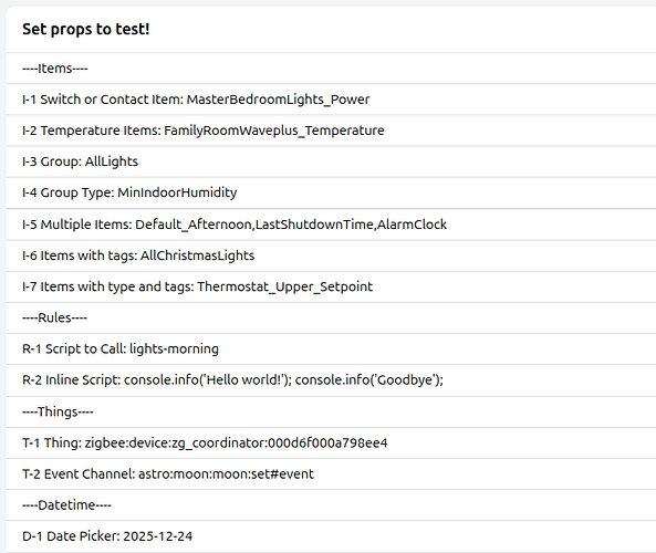

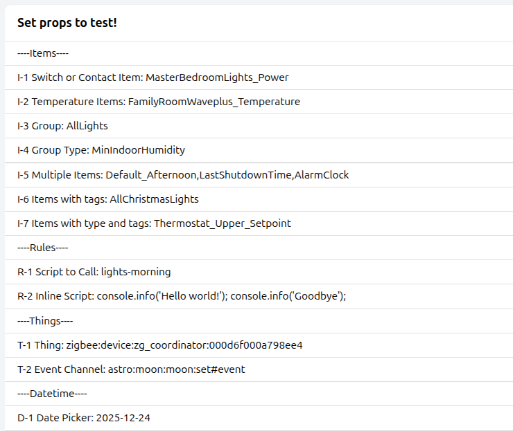

In the bottom left select Set Props, and you’ll be presented with a form showing how each parameter is displayed to the user to fill them out. On the right you will see exactly how that value will be passed into your widget once the parameter is selected.
I used numbering to help correlate the property with where it’s rendered in the widget. The order is not the same because the parameter Grouping will change the order the fields are shown to the user.
Some features demonstrated include:
  • grouping parameters so they are displayed together on the form
  • flagging parameters as advanced so they only appear when “Show Advanced” is selected
  • default values
  • selecting multiple (e.g. multiple Items)
  • filtering (does not work prior to OH 5.1 M3)
  • Item, Thing, Channel, rule/script pickers
  • Map picker
  • cron expression builder
  • Units
  • regex input checking
  • date and time pickers

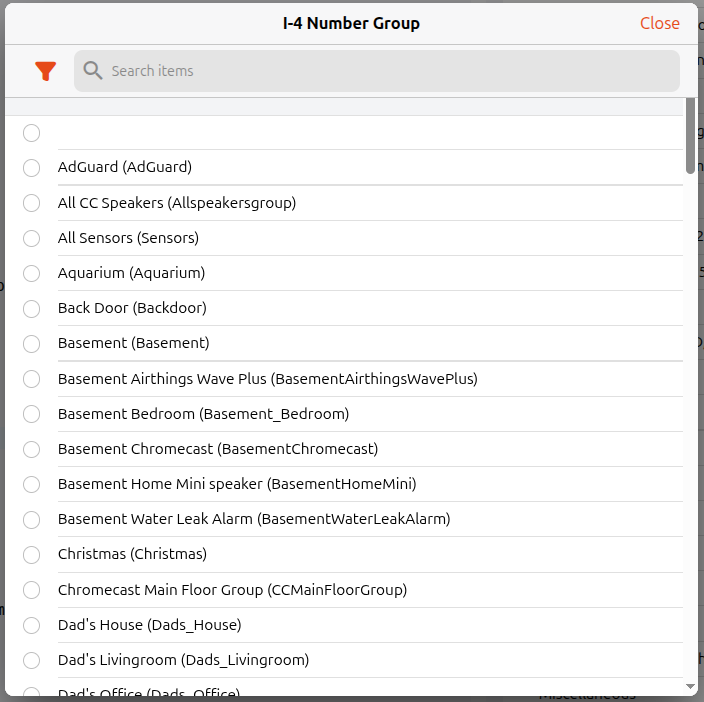

Some notes on filterCriteria are needed.
  • You can have more than one criterion on the same parameter which can be helpful to narrow down the list based both on tag and Item type.
  • Filtering on Number dimensions (e.g. Number:Temperature) works, but it will also so plain Number Items without units. this also applies to Group’s (e.g. Group:Number:Temperature).
  • I recommend always showing the filter button so the end users can choose something else. They know better than we do what’s appropriate.

Now that I’ve done a bit of work with the Number dimension filtering I wonder if it needs to be adjusted. I don’t think it makes sense to show the plain Number Items, particularly when we have the ability to turn off the filter now with the icon.
Consider this example. I have only two Items in my configuration that are of type Group:Number:Dimensionless. However, this is what I see when I set the filter to groupType Number:Dimensionless.
That’s basically all my Groups and because of the semantic model I have a lot of Groups. It really doesn’t narrow the list down in a useful way as a result.
Would it make sense to change that behavior?
I see your point. I am not sure about the best approach though.
The idea was to offer all possible groups for an item with Number:Dimensionless. When an item has a type, you should be able to only use groups with a compatible type or without any type at all. If you only show group items with a compatible dimension, I think you lose the main use case.
If you use type equal to Number:Dimensionless it will get you all items with compatible dimension, so also the groups with a compatible type, but not the groups without type.
One way could be to make both filters work together: if you set a type and a group type, only shows groups with a compatible dimension. Of course the type and group type should be set equal then.
What is the practical use case for only wanting groups with a specific dimension?
It’s more than a specific dimension. It’s the type too. If I want to get a Group of type Group:Switch, I also get the full list of all regular Groups.

While I agree with all that, shouldn’t you just be using a regular type constraint instead of a group type constraint in all these cases? The rule will still work. It will not force you to pick a group, but the rule can work with a regular item as well.
From what I can tell, this extra constraint that it should be a group item is only relevant in rule templates.
what about my suggestion to use both group type and type at the same time?
Why would I use a regular Number:Dimensionless Item plus a rule when I can use a Group:Number:Dimensionless:MIN without a rule?
If I want to be able to control a bunch of lights, how do I manage identifying those lights without listing each one individually in a rule?
That doesn’t make it any less worthy of being supported.
If I understand it correctly then I should be able to narrow down to just Group:Switch (for example) by putting Group:Switch for both the type and groupType, correct? That would work though it’s a bit counterintuitive.
If I were to design it, given the ability to turn off the filterCriteria, I would have made the filter more strict rather than less strict (i.e. not show the plain number Items if a dimension was specified as part of the filter or a type were specified for the Group). But I don’t have strong feelings about that. But as it is right now, it’s pretty much pointless to filter and anything more specific than Group.
A suggestion: it’s a niche feature but you might want to add it anyway.
You can add context: action to a parameterGroup and it will expand to the dynamic parameters relevant to a widget action, see the TIP box at the bottom of Building Pages - Components & Widgets | openHAB (and the expanded explanation).
Then some supported widgets like oh-button have a actionPropsParameterGroup parameter you can set to the name of the parameterGroup and it will perform the action as defined.
This is not what I meat at all. Clearly, using a group is the most logical and common thing to do. But it is not the only way. Someone might have a reason to use a standard item because they get the min from a rule ore a linked channel?
Anyway, if you select the item type to be Number:Dimensionless, it will get you all the items and groups that are compatible (i.e. Number and Number:Dimensionless) and no other groups. Anything it lists will be compatible with the rule.
I agree it is not ideal if you want to force it to being a group, but the question is if this is better or worse then showing all the groups that are compatible, including the ones without a type.
I didn’t say otherwise. But I don’t want to break the main use case I created this for in the first place.
I don’t like to rely too much on turning of the filter. Then I am back to the old situation, where when you want to add an item to a group, it also listed incompatible groups (because they had a type that was not compatible with the item type). If I only list the groups with a compatible type, I will miss most. If I then turn off the filter, I again get all incompatible ones. I think this is a much more common use case, already in configuration in the UI, and I don’t want to break that.
Turning the filter off, to me is something that is relevant for using profiles, where you end up with item types that are different from the channel type and it cannot be predicted in advance. In most cases, I want to avoid it and not open the possibility to have illegal options.
In summary, current behaviour:
  • type = some item type: will list all items and groups with a compatible type, no groups without type.
  • type = group: will list all group items.
  • group type = some item type: will list all groups with a compatible type or without a type. This always leads and type will be ignored if set.
The most logicial way forward for me without introducing extra parameters (and we can debate on the appropriate combinations), use all of the above, but add one extra treatment: if type = group and group type = some item type only list the groups with compatible type, not the groups without type. The inverse is a possibility as well (i.e. in that case it would also list the groups without type when type = group but ignore the ones not compatible with group type = some item type). I don’t have a preference.
I will give that a shot. It seems like it could be useful for UI Widgets for sure.
While I’m not aiming to be 100% comprehensive, I do want to try to include examples for every context at least.
One question though is where is that context handled? It’s not among those listed in ConfigDescriptionParameter (openHAB Core 5.1.0-SNAPSHOT API). Are there other contexts that are handled outside of that class that should be represented?
Sure, and we have the new cancel filter button you added to get to those.
But pretty much everywhere else in MainUI we have design patterns that promote the use of UoM through defaults and such. This would be the one exception where not using UoM becomes the default and encouraged behavior.
For Groups, I say it’s worse because you will always get all your semantic model Groups in the list and there will always be a lot of those. I’d assert there will be more semantic model Groups than any other type of Group, perhaps by as much as an order of magnitude.
If it were not for the semantic model I wouldn’t have a problem. But the semantic model makes the filter unusable. I’m no better off than if I didn’t apply a filterCriteria at all because I still have to scroll through dozens of entries or search.
I think this is where I struggle. If I want to see all my Groups I can use type group. But if I expressed a desire to only see Groups of a given type by using the group type, I still see pretty much all of my Groups because most of my Groups are defining the semantic model and don’t have a type. If I have 40 Group Items, specifying the group type on the filter gives me 38 instead.
This makes the most sense. The root problem is by showing the Groups without a type the filter becomes useless because of all the Groups that define the semantic model. Having a way to exclude those in the filter is needed or else the filter is kind of pointless.
When I wrote standard item, I meant a non-group item. It has nothing to do with UoM.
I actually think I will go the other way around. If group type = some item type restrict it to compatible group types, exclude groups without type, unless type = group is set as well. I have that prepared already.
Looking at the discussion, I think the real question becomes if we should create a filter to exclude semantic group items?
That works for me. In the end I mainly just want to get the list down to something reasonable.
Is that feasible? I wasn’t sure if doing so would be worth the extra call to the REST API to get the list of tags so I didn’t dare ask for it. I don’t think we can hard code the list since users can create their own. But that would be awesome!
While you are in that general area, would it be feasible to filter on semantic tags hierarchically? For example, if I filter on “Room” it gives all the Items with a tag that inherits from Room (e.g. Bathroom, Bedroom, Kitchen, etc). If you already have to pull the semantic tags, that seems like something that should be feasible and it could be useful.
I think it is. The items list in the UI used for filtering has semantics included in its data structure.
I think it would be possible. Looking at the internal item data structure used to feed the items in the item picker, I have something like the example below for each item:

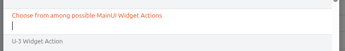

I’ve attempted to set up an example for a context: action and I’m not getting it to do anything so I might be missing something. I assume the type needs to be TEXT. But it’s rendering as just a plain text filed instead of a selector.
    - context: action
      description: U-3 Widget Action
      label: Choose from among possible MainUI Widget Actions
      required: false
      type: TEXT
      groupName: ui
(Yes, I have the label and descriptions swapped, I’ll fix that later).
