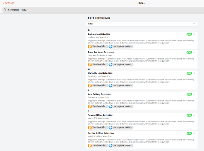

Consider this example from my personal OH system. Often times one will have a situation where they want something to happen when an Item(s) meets some criteria for a certain amount of time. Examples:
  • turn on the humidifier when the humidity gets too low for 15 minutes
  • send me an alert when no motion is detected for 8 hours
  • send me an alert when a sensor stops reporting new readings for 30 minutes
  • send me an alert when a service status remains OFF for 10 minutes
  • send me an alert when a battery gets below a certain level and remains there for 1 hour
  • send me an alert and repeat the alert when a door or window is left open for an individually configured amount of time
That’s a lot of different use cases, but they all do pretty much the same thing: wait a certain amount of time for an Item to remain in a state that meets a condition (e.g. humidity < 35 %) and do something. Stop doing that thing when it no longer meets the criteria.
I could write one rule to handle all of this. I could write size completely separate rules to handle all of these use cases. Or I can write a rule template with properties and instantiate a separate rule to handle all of these diverse yet related use cases with multiple configured instantiations of the same rule.

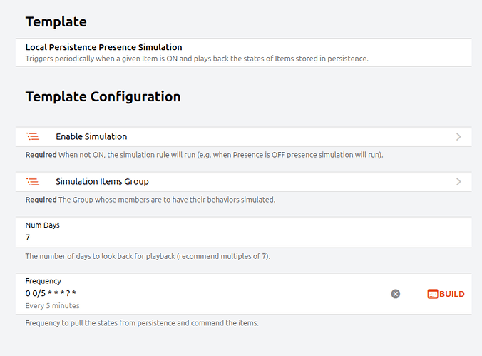

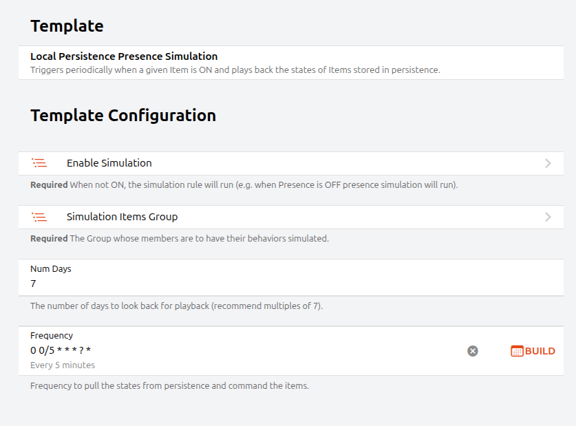

As you can see, the overall structure is YAML. It’s separated into five major sections: identity info, configDescriptions, triggers, conditions, and actions.
Identity
Here we have three fields which are used to uniquely identify the rule template:
  • uid: must be unique and follows the same naming restrictions as Things
  • label: This is the “title” of the rule template as it will appear on the new rule page
  • `descriptions: This is the description.
These are shown to the end users as follows.
2025-12-03_15-23
The segment of the code is
uid: local_rules_tools:presence_sim
label: Local Persistence Presence Simulation
description: Triggers periodically when a given Item is ON and plays back the states of Items stored in persistence.
configDescriptions
This is where you define your template parameters. Here we define four parameters, two Item pickers, a number, and a cron expression. You can see how we can restrict and constrain the parameters, provide defaults, specify certain parameters, etc. For more details and examples of just about everything you can do with parameters for bothUI Widgets and Templates see Parameter Playground. Note you can install this UI Widget for your reference.
This particular config appears to the end users as this.
These should look familiar to you as they are the same UI widgets used elsewhere to pick Items and build cron expressions.

How Do I Refresh a Rule Based on a Template?
Thankfully this has become much easier. At the top of any rule created by a template is a “Regenerate” button. If you’ve selected a single rule, you will be presented the parameters form again, giving you the opportunity to change the parameters to adjust the rule’s behavior. Clicking “Regenerate” again will recreate the rule with any changes made to the rule template and any changes made to the parameters.
If you select more than one rule from the rule’s page and click regenerate, only the code of the selected rules will be updated with any changes made to the rule template, keeping the same parameter values.
Rules created from a template will be tagged. You can search for the tag to find all the rules created with the same template.
This is a convenient way to refresh all your rules based on one template.
