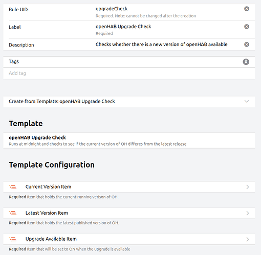

Identity
Here we have three fields which are used to uniquely identify the rule template:
  • <template_uid>: The root element of the rule template definition is the unique identifier for the rule template. Take care to make this very unique when posting to the marketplace to avoid colliding with other rule templates already posted.
  • label: This is the “title” of the rule template as it will appear on the new rule page
  • description: This is the description.
  • tags: These will be added to every rule created from this template.
These are shown to the end users as follows.
2025-12-03_15-23
configDescriptions
This is where you define your template parameters. For more details and examples of just about everything you can do with parameters for both UI Widgets and Templates see Parameter Playground . Note you can install this UI Widget for your reference and experimentation.
This particular config appears to the end users as this. The context controls what type of UI widget is presented to the user. In this case, context: item presents an Item picker and the filterCritera should limit the Item to just those of the given type.
In the YAML, the name of the config parameters are the root element to the section. In the above example you should see three parameters being defined: curr, latest, and up.

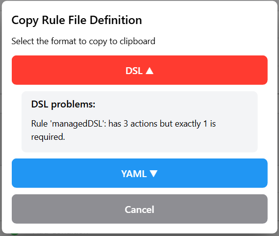

When you click on the “code” tab for the rule in MainUI if you see a blue “YAML” button at the bottom left the rule can be converted to a rule template following this tutorial. If not, it is created in a way that cannot be automatically converted to the YAML format.
How ever you choose to develop the rule, obtain the YAML format for that rule by clicking on that blue button. If you developed it as YAML to begin with you can move to the next step. The YAML you see in the code tab is the new YAML file format.

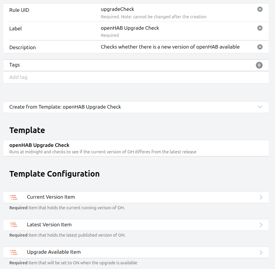

Create a Rule from a Template
  • In the UI you can choose + to create a new rule and select the template from the list in the middle. Then fill in the properties and “create rule”.
  • In a YAML file you can add your rule as normal but include the template element with the UID of the template and if there are parameters, a config section with values for the properties. See YAML Rules | openHAB for details.

A tip here is to press the Copy File Definition button on the bottom of the “Design” tab if a rule can’t be expressed as a certain format, and you will be told why with a dialog like this:
It might be something trivial that can be changed easily, that said YAML can handle most rules except SimpleRules and DSL rules with shared context.
Maybe I misunderstood this, but to make a “stub” in YAML, add a rule element, specify UID, label and template UID, in additions to the config section. A rule will be instantiated when the file is parsed.
No, I thought you told me it wont work. It it will work that would be great! I don’t have a use for it just this moment but I have in the past.
Maybe I misunderstood. I’ll remove that from the OP and will assume it works until I know otherwise.
:+1:
That’s what I meant. I clearly mangled it. That’s what I get for being in a hurry. I’ll fix it above too.
