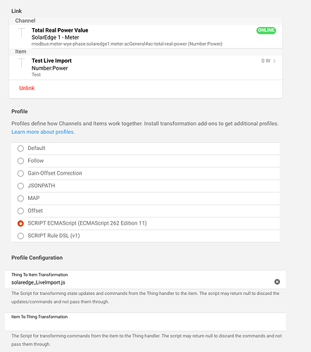

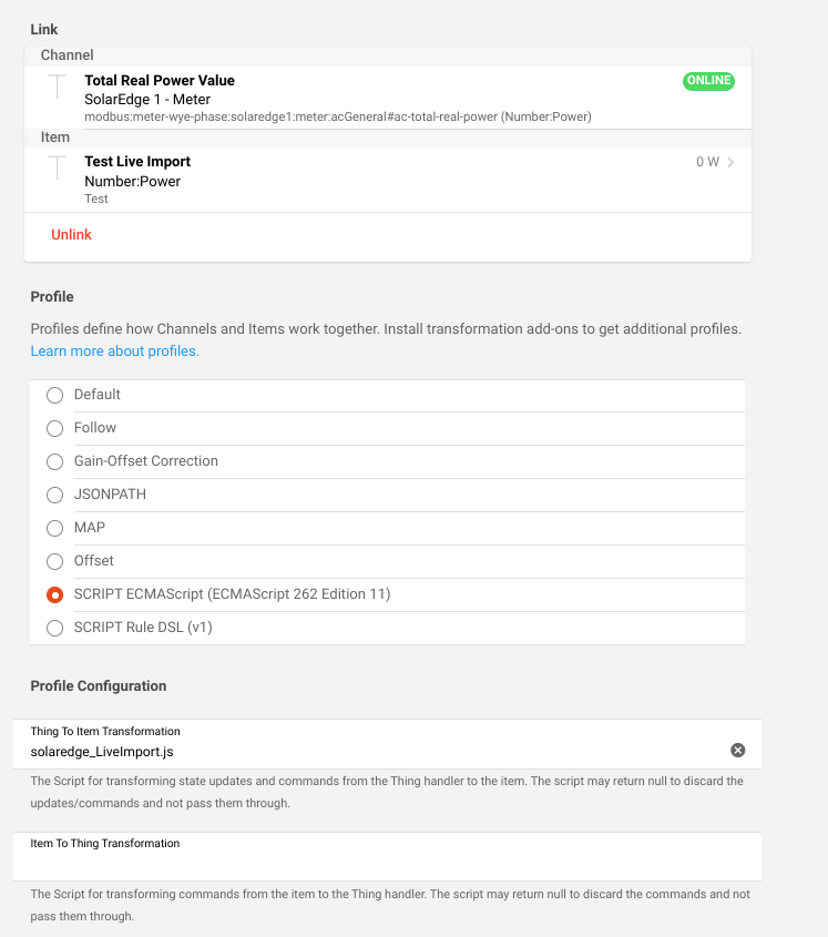

Here is a creenshot from the UI created file

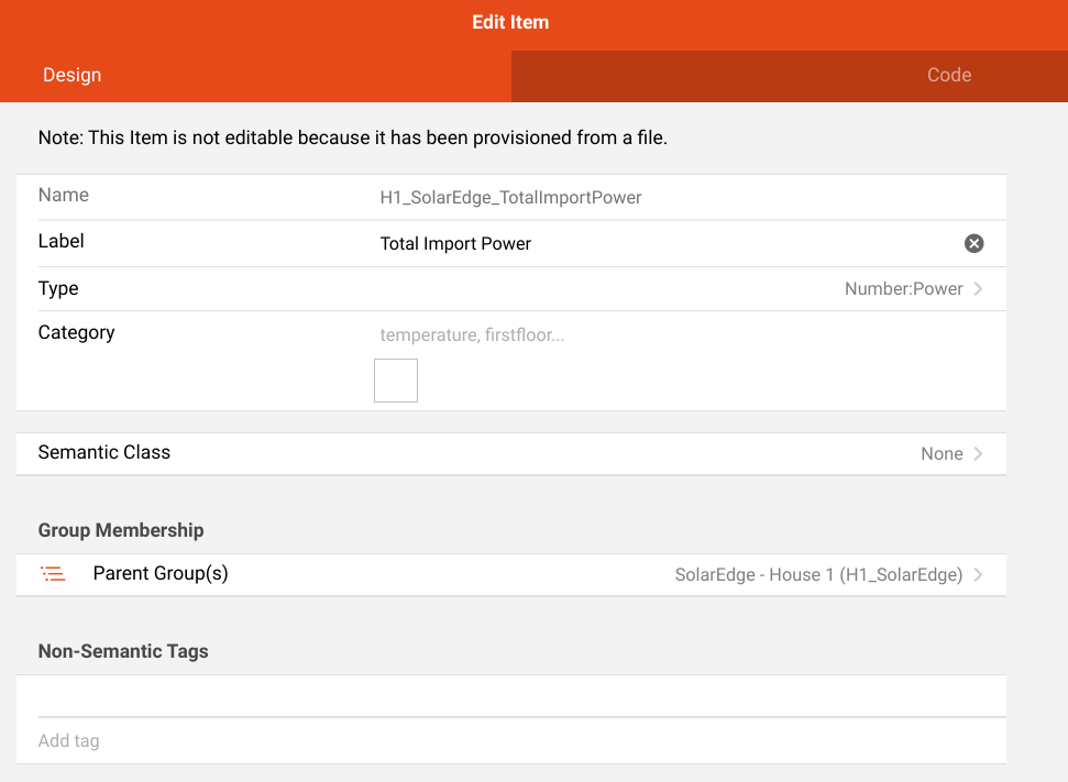

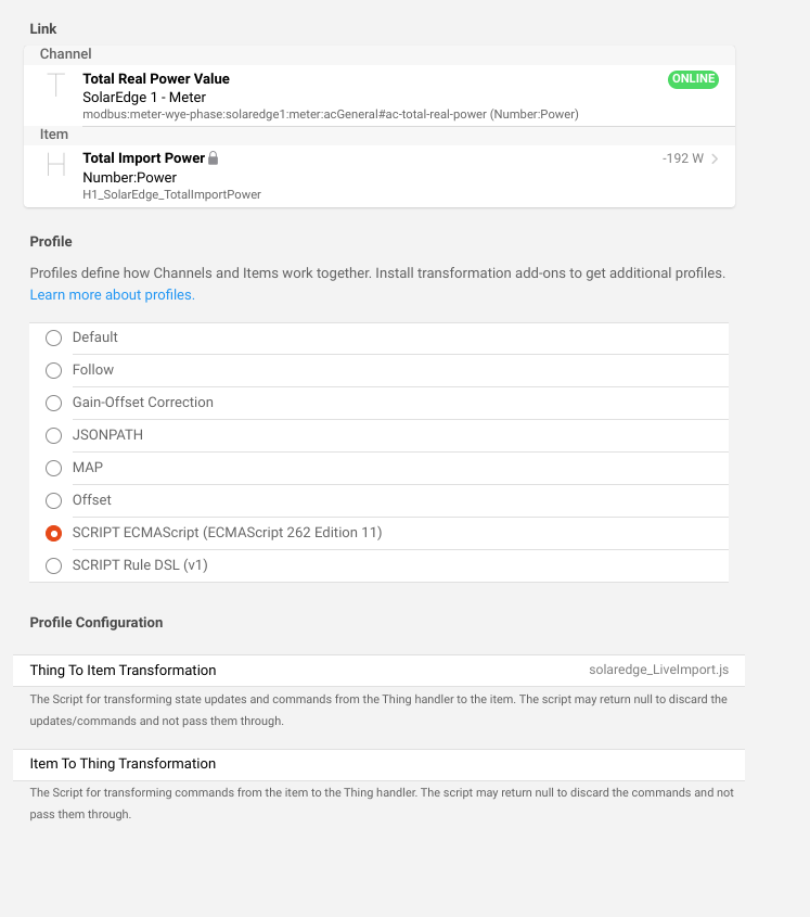

Here is the text file created item
When I save the items file, I get this error in the log
Neither 'toItemScript' nor 'toHandlerScript' defined in link 'H1_SolarEdge_TotalImportPower -> modbus:meter-wye-phase:solaredge1:meter:acGeneral#ac-total-real-power'. Profile will discard all states and commands.
I can’t find any difference that would stop the transformation working…

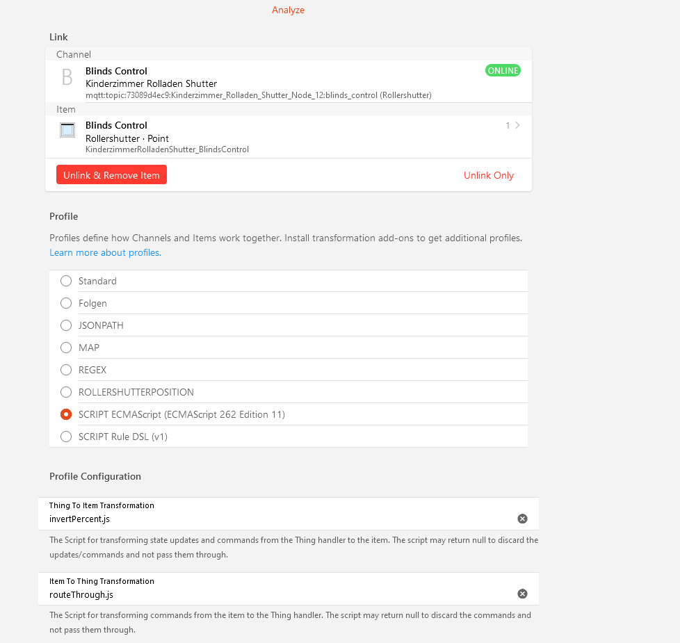

I had a similar problem you have to enter something for both transformations.
I therefore wrote an empty transformation.
routeThrough.js
(function(i) {
	return i;
})(input)
