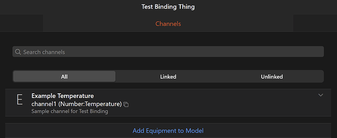

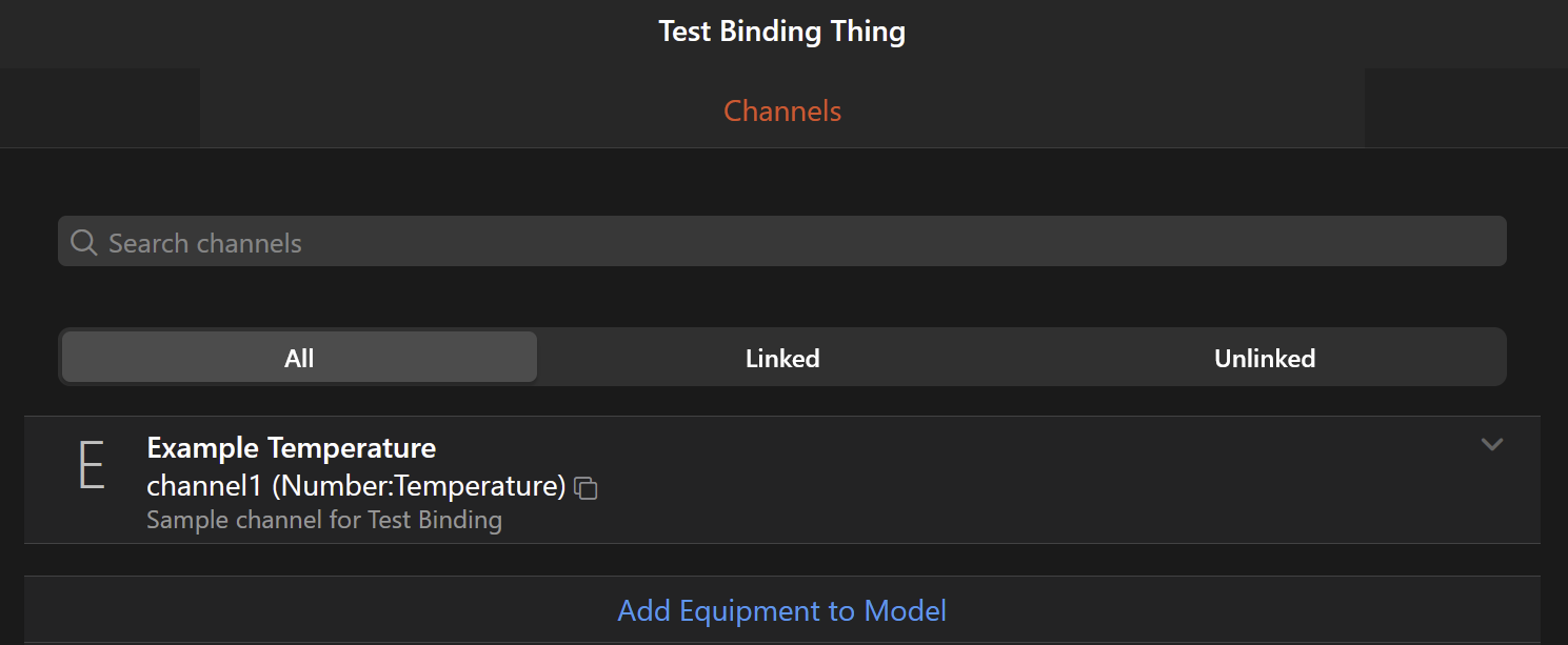

I’m working on a new binding that requires several channels to be created dynamically, based on the feedback from the device.
I followed the example from updating-the-thing-structure and also the implementation from other bindings without success. Bundle loads without warning/exception, goes ONLINE but the channel list only shows the pre-defines static channels from thing-types.xml
