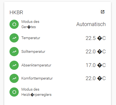

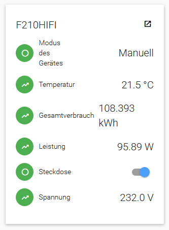

After Updating from 2.5.0M1 to M6 special characters ar not presented well
It worked fine in V2.4 and V2.5.0M1
e.g.: AVM Fritzbox BindingTemperature: 22.0 �C
Heizk�rperreglers
this in paper-ui as well as in Habpanel.

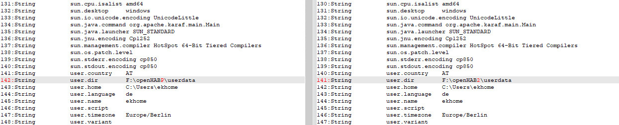

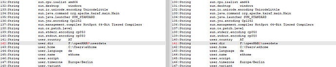

But your Java install on Windows still has language environment settings, which you can check using env in a karaf console.
kaper25
(Kaper25)
December 9, 2019, 3:02pm
10
ENV is ident on languagerelated items.
Different are the ports and directorys due to the same instance.
