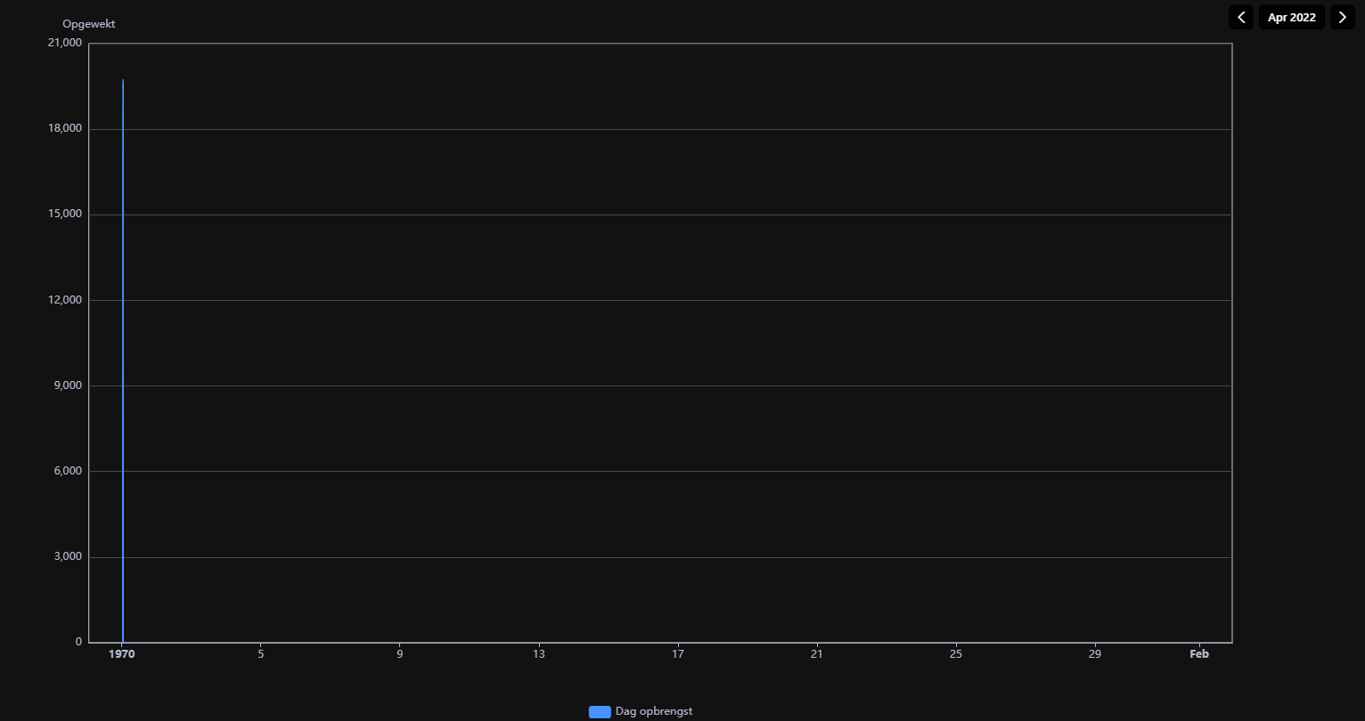

    I’m trying to make graphs that can show the power usage and generation per day/week/month (depending on the device and the available data). This is data coming from a Smart meter (DSMR P1) and data coming from a SolarEdge installation in the house.
    In this case the SolarEdge provides the data of day to day generation and monthly generation itself, no fancy math or anything required. The DSMR needs a bit of fiddeling where the previous day is substracted from the current day value.
    The SolarEdge graph always shows but is somehow fixed to 1970. The DSMR data only shows when editting the page and going into the run mode (but result in the same strange behaviour).
When making any aggregated series chart the date of the chart immediately goes to 01-01-1970 and shows the value only on that day.
Tried to fix another chart too see if i’m doing something wrong and it seems to behave the same. The strange thing is when I have the chart drawn as regular time series the graph shows just fine.
I currently have a graph for both, but they behave the same way and I currently don’t see what I’m doing wrong:

This should show the production per day, but comes up like this:
Any ideas on what is going wrong here?
Small bit of extra info here:
The SolarEdge data is always reset on the new day / month.
The value shown in the graph is 18743Wh while the value measured for today is 14659Wh.

This is a sign that the date is not being supplied. On most computers, date and time is actually represented by the number of milliseconds since midnight, January 1st, 1970 GMT. So when you see a date time with a dare in January 1970 that’s a pretty good sign that the date is not being considered.
That’s interesting.
Go to Developer Tools → API Explorer → persistence → GET /persistence/items/{itemname} and query for some data on one of your Items. This will return something like:
  "name": "TestSwitch",
  "datapoints": "2879",
  "data": [
      "time": 1649857800000,
      "state": "ON"
      "time": 1649857860000,
      "state": "ON"
Those "time" entries are in epoch (num milliseconds since the start of 1970). You can use a website like https://www.epochconverter.com/ to convert that to human readable form.
1649857800000 becomes Wednesday, April 13, 2022 7:50:00 AM GMT-06:00 DST.
Verify that the times for a few entries makes sense. That will tell us if the problem is in the persisted data (which is unlikely since the one chart works) or the problem is in the UI.

I’ve gone through the data. I indeed thought that it would had to do with the epoch time but it doesn’t explain why one chart is working.
I gotten the data of one of the items and the epoch time that it returned makes sense when looking at it:
  "name": "SolarEdgeOmvormer_Aggregate_Day_Production",
  "datapoints": "1440",
  "data": [
      "time": 1649870940000,
      "state": "14603.0"
      "time": 1649871000000,
      "state": "14603.0"
      "time": 1649871060000,
      "state": "14603.0"
      "time": 1649871120000,
      "state": "14630.0"
      "time": 1649871180000,
      "state": "14630.0"
      "time": 1649871240000,
      "state": "14630.0"
      "time": 1649871300000,
      "state": "14630.0"
      "time": 1649871360000,
      "state": "14630.0"
      "time": 1649871420000,
      "state": "14630.0"
So I don’t think that that is the issue.
– Edit [15-10-2022]:
I’ve gotten the graphs fixed. Currently the data is showing and the graphs don’t bug out anymore.
It took some fiddeling and re-adding the graphs multiple times, but they now look something like this:
