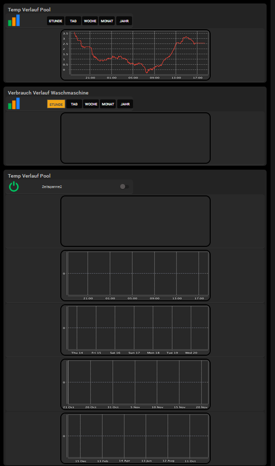

i am experiencing a strange behavior of the Chart item in basic UI.
I realized the first chart with the Temperature from a Sonoff TH16 flashed with Tasmota.
Everything is running fine.
I added another chart from a Sonoff POW R2 Tasmota flashed. Runs too.
After adding a third chart from another POW R2 Tasmota flashed, the third chart shows a strange behaviour…

This is the picture it gives:
What really disturbes me is that the third chart shows five pics and when i change the name from CHART_TR to CHART_WM or CHART_PERIOD like one of the other 2 it gives the right display with the buttons and only one pic…
The items CHART_WM and CHART_TR are identicall, just the names differ…
I can change CHART_TR to anything and it wont work. Changing it back to one of the other 2 it displays normally.
The only thing that is different is that CHART_TR does not have any data yet. Could it be the missing data?
Any ideas?
Thnx.

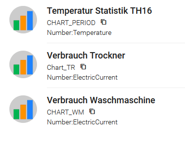

What are the item-types of all the “CHART_XX” items?
Number with the Type.
AHH HAHAHA The item doesnt exist… CHART_TR and Chart_TR.. thnx…
Sometimes you just need to explain your logic to someone and youll find the answer yourself :slight_smile:
I checked the items 3 times to be the same, didnt see the Caps Difference…
The item to select the charts should be a plain Number! Any UoM (Unit of Measurement) is not needed.
