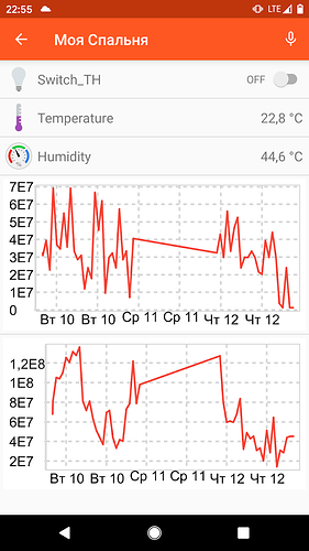

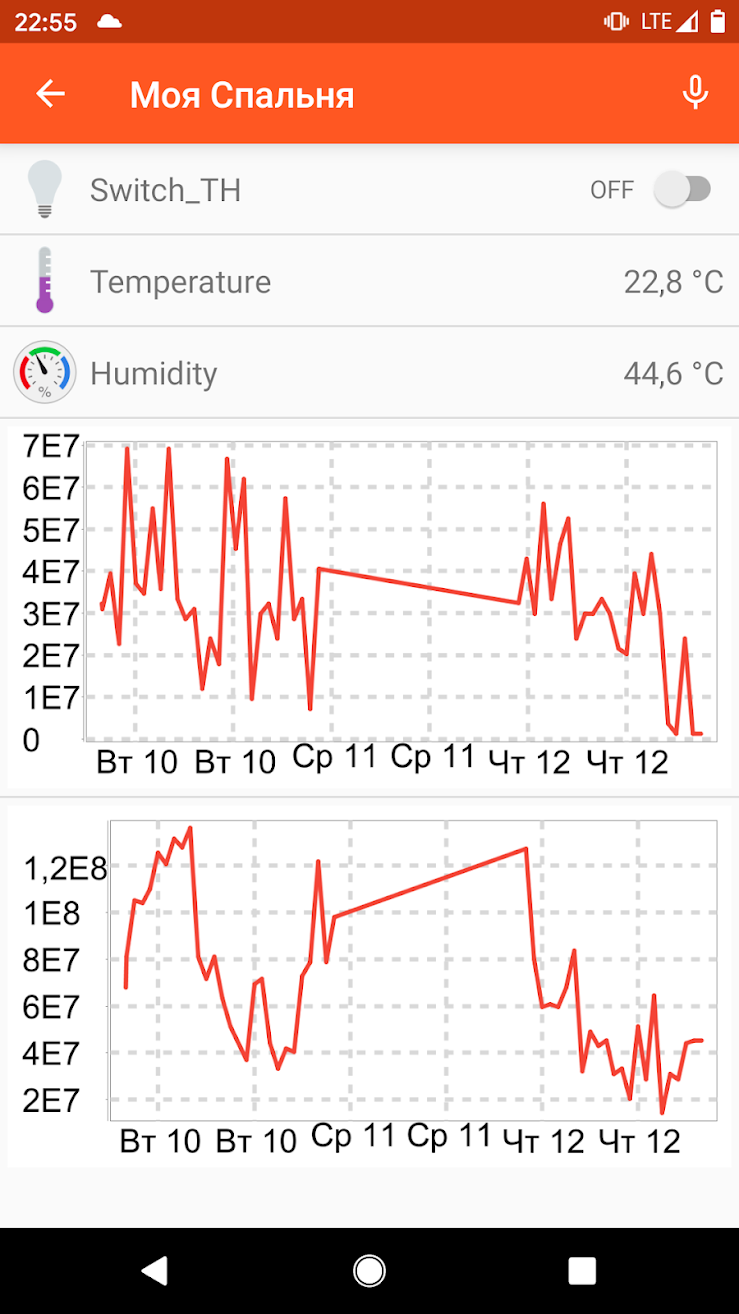

Hi all, I have use chart to dispaly temperature value. Everyting works well under Ubuntu, but wher I moved my configuration into Windows 10 installation, the charts start dispaling a temperature value in ecponentional format, like it demonstarted in attached pictures. Anybody can help me with adivice?

Not strictly true. And the screenshots shown are of BasicUI using the built in charts. See https://www.openhab.org/docs/configuration/sitemaps.html#element-type-chart.
@aarefiev, that is very unusual behavior. Sadly I’m not sure which repo hosts the charting servlet. I’m going to guess core. All I can recommend is to look at the settings under Configuration -> System -> Regional Settings and make sure they are reasonable and if so file an issue. See How to file an Issue.

I doubt the phone app has anything to do with it. By the time the chart gets to the phone, it’s just a picture. The thing creating the picture is where the problem resides and that’s the charting servlet.

I posed the picture from mobile apps but I have the same picture in BasicUI. I hope that problem related with regional settings, i am from Russia. But when I am changed the regional setting in Windows and OH2 it dosen’t helped me. I am looking for the same problem on the community and git and didn’t found the same issues. I am correct to understend that the best way it is to post this issue on githab?
Yes, I believe filing an issue is the next step. Something weird is going on with the numbers and the chart servlet is the only place I know of where the problem could be,
