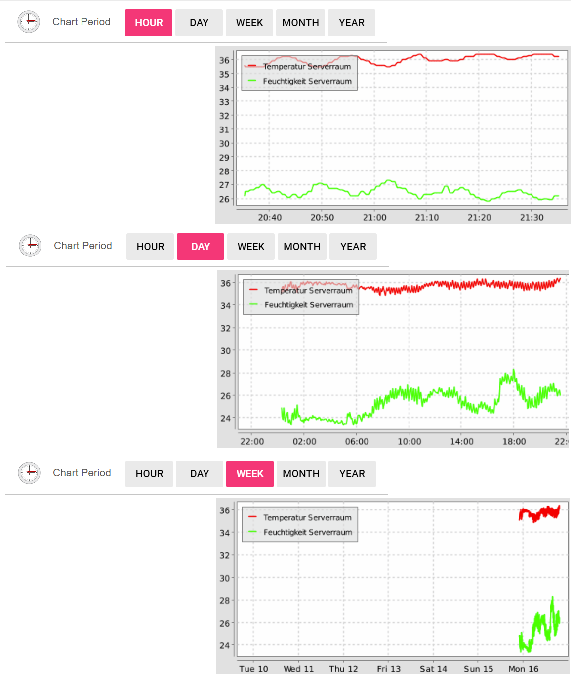

    My Charts only show a fraction of the data. The hourly chart seems to be fine but the daily chart is already missing the last 2 hours and the weekly charts only show about 1,25 days worth of data. The persistence service has been running for 2 days. I tried to delete all the storage files in hope that it would fix the problems … with no effect … I already had multiple days of data but with the same result.
    I also reinstalled rrd4j …
here is a compilation of screenshots:
And here is my configuration:

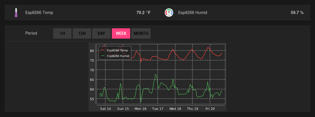

I have similar setup, no issues, except I’m using a RPi2. Comparing what I have against what’s posted, the only difference is … In persistence you have default = everyUpdate. I have default = everyChange and my items below, are all on a separate line. I never changed my rrd4j.cfg so maybe setting it back to default would help. Hope this helps.
I renamed my rrd4j.cfg and then uninstalled rrd4j and reinstalled it again. I also changed my rrd4j.persist to “everyChange” even though I don’t thank that’s the problem.
I also deleted all of my existing *.rrd files. Will keep you posted :slight_smile: Thanks for the reply :slight_smile:

I had to go file digging but I found some of my old configs.
for Items:
yGroup Home_Sensor_Chart (Office, Charts)
//Number Home_Sensor_Chart_Period "Period" (Office)
//Number Home_Temp_Office "Office Temperature [%.1f °F]" <temperature> (Home_Sensor_Chart) { channel="exec1:command:officeTemp:output" }
//Number Home_Humid_Office "Office Humidity [%.1f %%]" <humidity> (Home_Sensor_Chart) { channel="exec1:command:officeTemp:output" }
// Output of command line execution
//String Home_Temp_Office { channel="exec1:command:officeTemp:output" }
//String Home_Humid_Office { channel="exec1:command:officeHumid:output" }
For Things:
Thing exec:command:officeTemp [
//	command="python /etc/openhab2/scripts/OfficeTemp.py",
//	interval=45,
//	autorun=false,
//	transform="REGEX(Temp=(.*?))(Humidity=(.*?)'%)"]
Sitemap:
sitemap HomeTemp label="Home Office Sensor"
	Frame {
		Text item=Home_Temp_Office
		Text item=Home_Humid_Office
	Frame {
		Switch item=System_Temperature_Chart_Period mappings=[0="1h", 1="4h", 2="8h", 3="12h", 4="24h"]
		Chart  item=System_Temperature_Chart period=h   refresh=60000 visibility=[Home_Sensor_Chart_Period==0, Home_Sensor_Chart_Period=="Uninitialized"]
		Chart  item=System_Temperature_Chart period=4h  refresh=60000 visibility=[Home_Sensor_Chart_Period==1]
		Chart  item=System_Temperature_Chart period=8h  refresh=60000 visibility=[Home_Sensor_Chart_Period==2]
		Chart  item=System_Temperature_Chart period=12h refresh=60000 visibility=[Home_Sensor_Chart_Period==3]
		Chart  item=System_Temperature_Chart period=D   refresh=60000 visibility=[Home_Sensor_Chart_Period==4]
You may not need a thing item, I was using it to call for the script and transformation. I’m thinking it was also allowing me to have a string and number in my items file? You are getting a reading on your chart so I would try the thing file last.
Do you have Day_Period (from your site map) in your items file? I also notice that my site map has uninitialized at the end if the first chart line for period=h.
BTW ignore the // in the code, I had stopped it from running a week or so back. Loaning sensor to a friend.
I am actually not quite sure yet what my problem is but i don’t think it’s the chart but the datacollection.
I changed my persist file and I now directly list the relevant temperature sensor. I still have groups in it but I also list some item directly now.
I get some odd results from the REST API:
{“name”:“SonoffTH01_T”,“datapoints”:“227”,“data”:[{“time”:1532117160000,“state”:“36.60000000000000142108547152020037174224853515625”},{“time”:1532117370000,“state”:“36.5857142857142889624810777604579925537109375”},{“time”:1532117580000,“state”:“36.55714285714285693984493263997137546539306640625”},{“time”:1532117790000,“state”:“36.5”},{“time”:1532118000000,“state”:“36.4714285714285750827912124805152416229248046875”},{“time”:1532118210000,“state”:“36.41428571428571814294627984054386615753173828125”},{“time”:1532118420000,“state”:“36.5”},
this is just a small sample size but if I transform them into normal timestamps I get this:
1532117160000: Friday, July 20, 2018 8:06:00 PM
1532117370000: Friday, July 20, 2018 8:09:30 PM
1532117580000: Friday, July 20, 2018 8:13:00 PM
1532117790000: Friday, July 20, 2018 8:16:30 PM
1532118000000: Friday, July 20, 2018 8:20:00 PM
1532118210000: Friday, July 20, 2018 8:23:30 PM
1532118420000: Friday, July 20, 2018 8:27:00 PM
With the strategy “everyMinute” I should get a datapoint every minute right?
I changed my rrd4j.persist file and removed the “everyChange” strategy from all Items.
It looks like this now:
// persistence strategies have a name and a definition and are referred to in the "Items" section
Strategies {
// for rrd charts, we need a cron strategy
        everyDay : "0 0 0 * * ?"
        everyHour : "0 0 * * * ?"
        everyMinute : "0 * * * * ?"
 * Each line in this section defines for which item(s) which strategy(ies) should be applied.
 * You can list single items, use "*" for all items or "groupitem*" for all members of a group
 * item (excl. the group item itself).
Items {
        // persist all items once a day and on every change and restore them from the db at startup
        //gTH01_Sensors*,gSonoffB_Sensors*: strategy = everyChange, everyMinute, restoreOnStartup
        SonoffTH01_T, SonoffTH01_H:  strategy = everyMinute, restoreOnStartup
        SonoffB13_T1, SonoffB13_T2, SonoffB13_T3, SonoffB13_T4, SonoffB13_T5:  strategy = everyMinute, restoreOnStartup
        gOctoTemp*:  strategy =  everyMinute, restoreOnStartup
        gRSSI ,gRSSI*: strategy =  everyMinute, restoreOnStartup
hopefully that fixes the problem…
see: The strategy everyMinute (60 seconds) has to be used, otherwise no data will be persisted (stored).
gTH01_Sensors*, gSonoffB_Sensors*, gOctoTemp*, gRSSI*, gReachable*: strategy = everyUpdate, everyMinute, restoreOnStartup

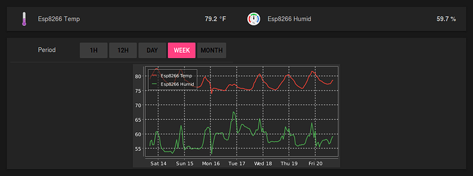

Here is a screen shot of weekly and no issues with other time periods.
