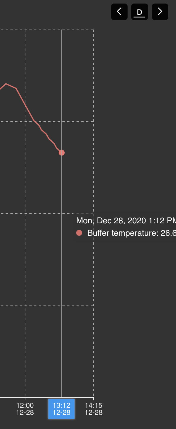

In the demo I really liked the Temperatures page with the trend lines and Analyse option. So I added a first item to a page and it works almost fine, but it seems to be missing the last hour of data in the chart.
I use a mariaDB for persistence.
I checked on all timezone settings and they seem to be ok.

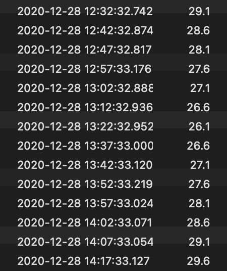

The data is present in the database:
But the chart is missing out the last hour of data.

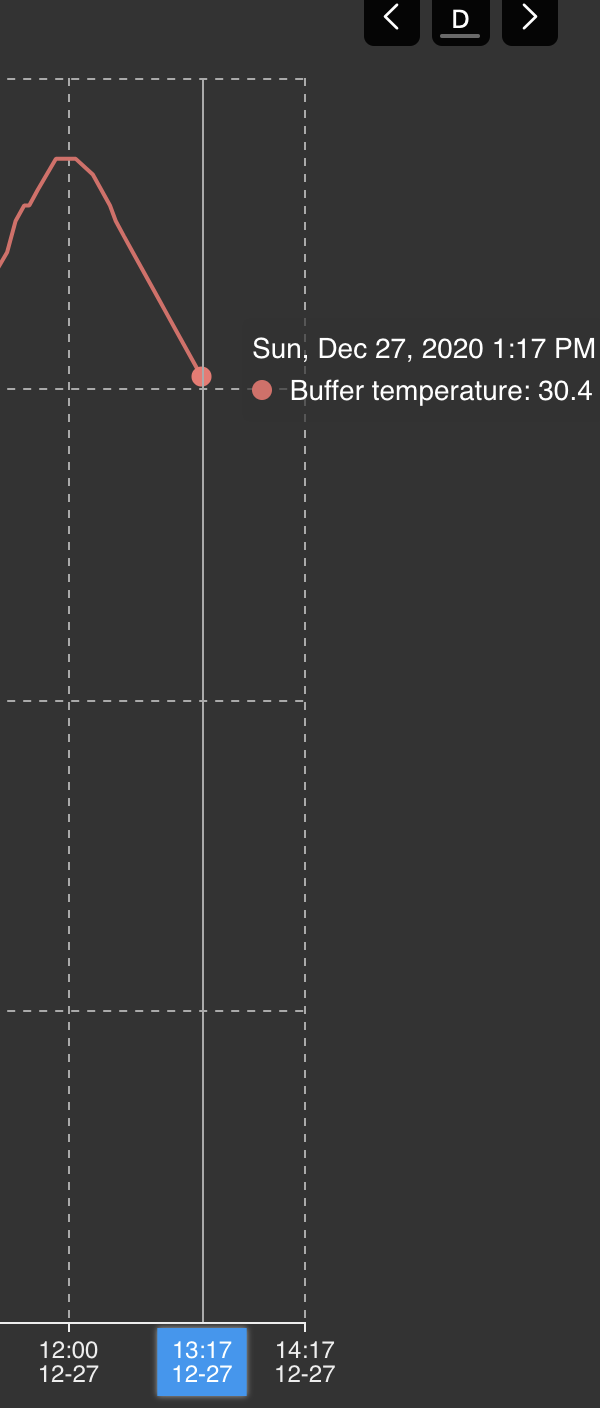

I noticed that also when you navigate to the previous day this happens.
