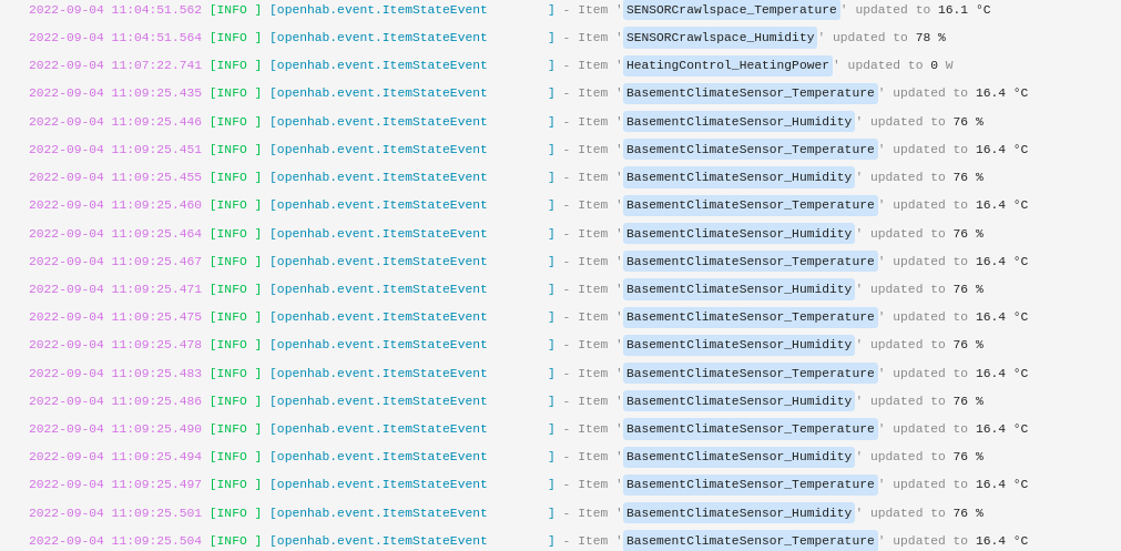

Another thing I could mention is that each update of the temperature and humidity is updated tons of times with the same value. I counted around 75 updates within less than a second:
I’m using the tellstick binding for this (over the cloud, Telldus Live), and my assumption has been that the devices simply send the same value over and over to ensure at least one reaches the bridge.
I don’t think it’s related, since these bursts happen with minutes in between, and the long loading times of the charts are very consistent.

Ok, so maybe this symptom is relevant after all.. I don’t have rrd4j installed, so that should not be it. Anything I can do to dig further into this? Maybe enable some more logging?

The problem is here. You are persisting way too may measurements.
I don’t know what the tellstick binding does..
For a fast fix you could change the strategy to “everyChange” or log it in a fixed interval like every 5 minutes.
From that point your charts will load a lot faster.
Of course! :man_facepalming:All 75 updates are saved every 10 min. I didn’t see it on the chart because they are so close to each other. Thanks a lot for pointing it out!

No it is not every 10 min. It is every second. I don’t know where you have the 10 min from.
You should really change the strategy. You can also put seconds if you like.
This i don’t know. Yes open a new topic where you describe your problem separate.
I thought the everyUpdate setting saves the state of the item every time it updates, rather than at fixed time intervalls? This would explain my issue since the temp and humidity values are sent every 10 min from the sensors, but for some reason the update is duplicated 75 times. Where does the every second update come from?

Ah ok, I misunderstood your analysis from the log. I was thinking this is permanently.
So you are right with your explanation for the strategy.
