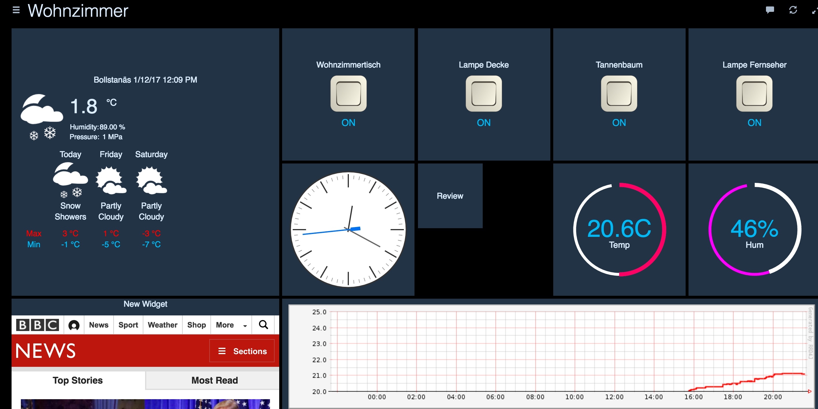

I am experimenting with HABpanel and made a dashboard. I realised that my RRD4j chart seem to get stuck and not refreshed, even though my other tiles are. Just reloading the page seem to bring the RRd4J chart up to latest?
Am I missing something?
