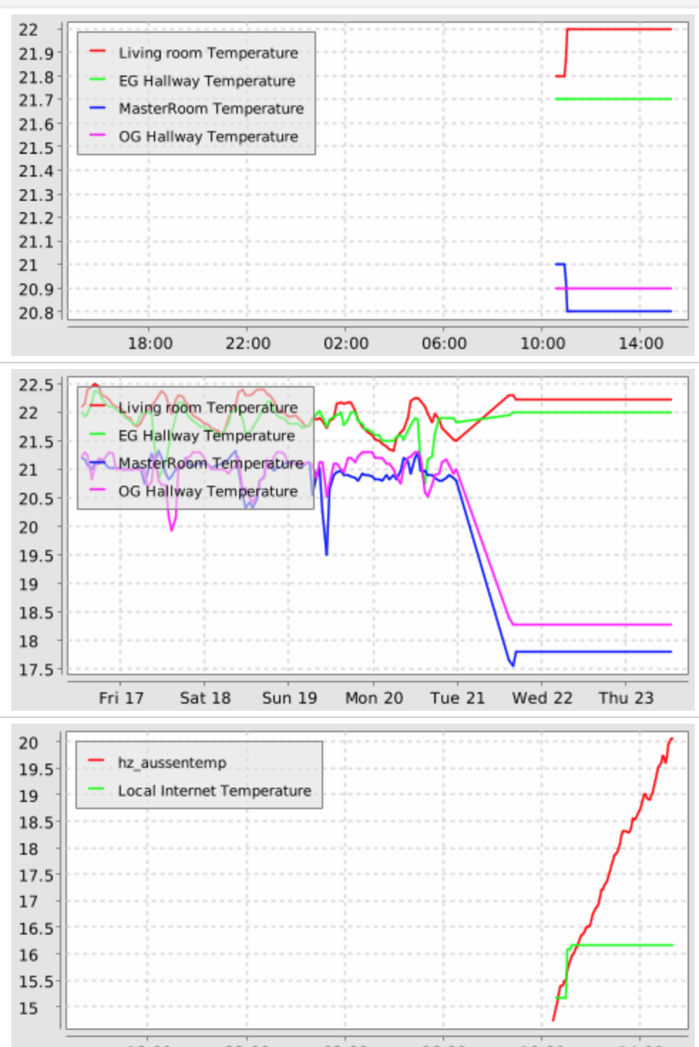

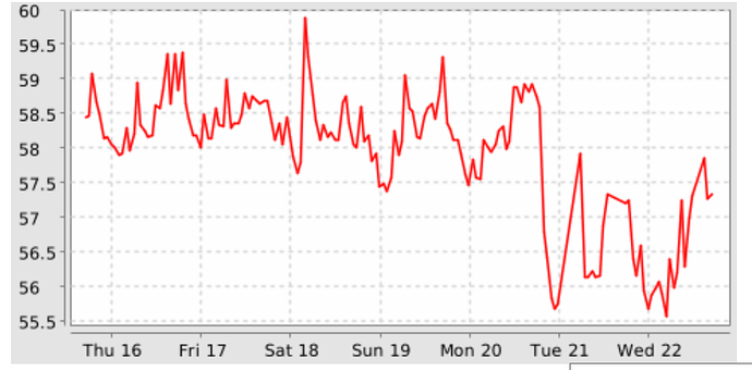

What’s funny is that indeed some values are showing up and some not. I had added a new binding and since then, some of these charts are not being updated like the first one, but the second chart is still being updated. The rrd files for all the values have an updated time-stamp.
Funnily enough, the binding that I added doesn’t have anything to do with the items that are plotted in the chart.
I also tried to remove all the old rrd files, but that didn’t solve the problem - the exact same values were being shown in the chart with the newer files as the older one. The values of the temperature are being updated as evident from the events log file.

UPDATE: so after some more playing with Rest API, when I choose an earlier starting date, I do see some data, (see below). As I said earlier the files are being touched by the Persistence since the time-stamps are updated, but the data is not there. Seems like Persistence opens the file but doesn’t actually write to it.

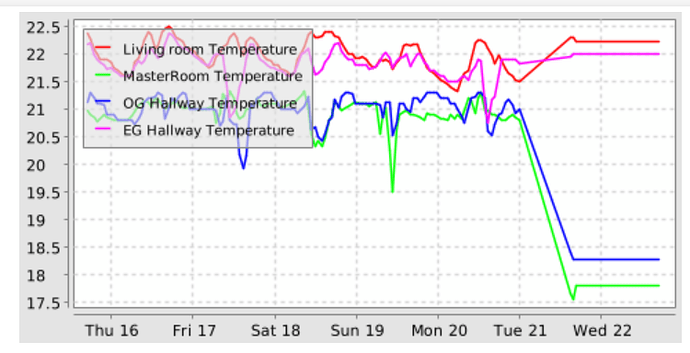

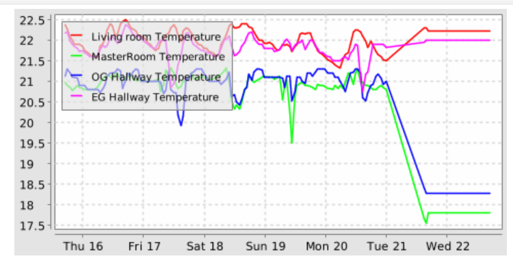

So it seems I was a bit hasty in assuming that the error was fixed. Apparently, after clearing the cache only the initial values were stored for all the values that I tested. Thereafter, the same problem reappears, i.e. only a few values are being stored, as visible in the graph below.
Perhaps that is the problem indeed. Initially I only started out with 50+ items, so I thought it would be fine. Maybe with 200+ it is reaching its limits. I do have an SSD attached (through an external hub) though, so normally it shouldn’t be a problem, but then who knows!
