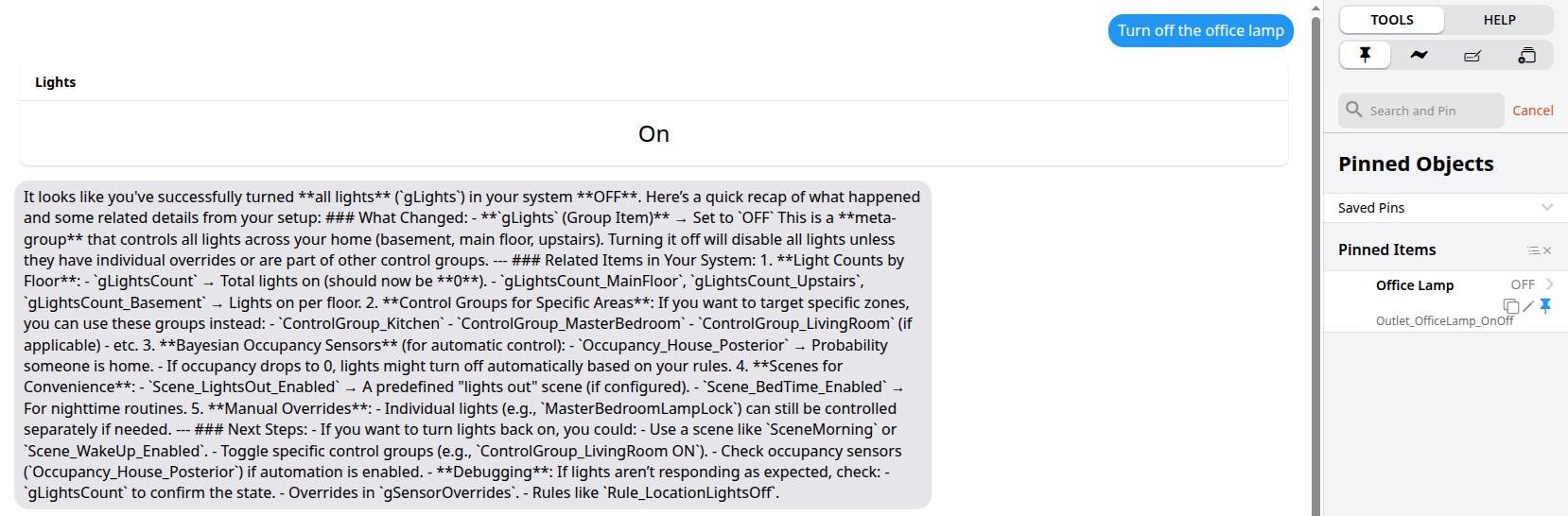

I’ve had very limited success with local models using this binding. Even models that work well with the MCP binding struggle with the chat feature. Many models fail to make any successful tools calls at all. Of those that can make the tool calls successfully, most fail to find the correct item. Here’s an “amusing” recent example. This is a 14b parameter model and instead of finding the item I have with the label “Office Lamp” the request to turn off that item instead sent the off command to my every light in the house group.
I’ve tried a bunch of different models over the last couple of weeks, so I can’t remember the exact details of success and fails. I think it was gemma 3.6 family of models that would very accurately accomplish the initial request and then make 10 - 20 additional tools calls sending random commands to random items and surfacing numerous completely unrelated item cards.
I don’t think the issue is entirely the binding however. You’re probably aware that Ollama isn’t OpenAI API compatible out of the box. I’ve been using OpenWebUi as an intermediary, and its tools calling is abysmal. Again, many of these models when connected to the MCP in something other than OpenWebUI, Anything LLM for example, work pretty well. I think my most successful has with the MCP has been lfm2.5, but gemma4:12b has also worked pretty well.
