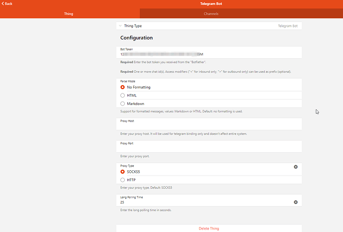

Hi Gurus,
I am trying to add Telegram Bot thing into my new OH3 instalation (docker) and I have no clue where to add chat id(s). Am I blind?
I was able to add Bot Token, but field for chat id(s) is not visible.
Thanks in advance for help.
And I thought yesterday I was blind
