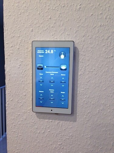

Here is the image how it looks on my wall. The power cord I’m going to replace with flat 90° one or from wireless charger. The 5V USB charger is from american iPhone - very compact, so that it fitted in hole behind tablet.
The viewing angle is not super, but resolution and brightness are OK.

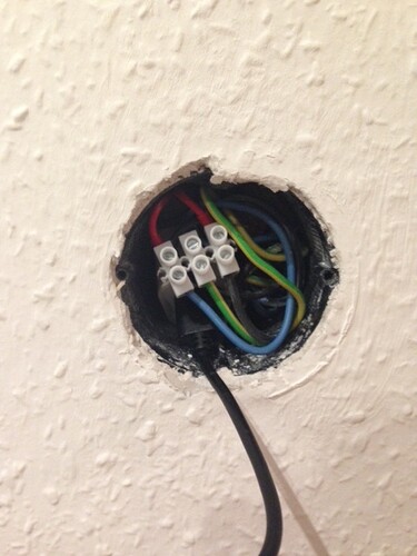

Hi @Niko_Izsak. I will post couple of more photos this week. Basically I have an opening in the wall for wall-mount 230V socket behind the tablet. Instead of socket I used a 5V USB charger from Iphone - it’s very compact, so it fits without problem there.

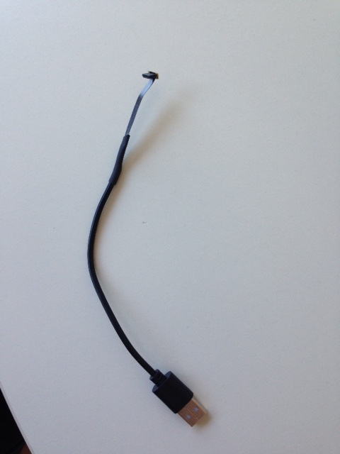

The cable was made from old USB Cable and flat MicroUSB part of Chinese wireless charger.
As I said behind tablet I have an opening for socket. There I inserted american version of iPhone USB charger - it’s compact, that it fist there easily.

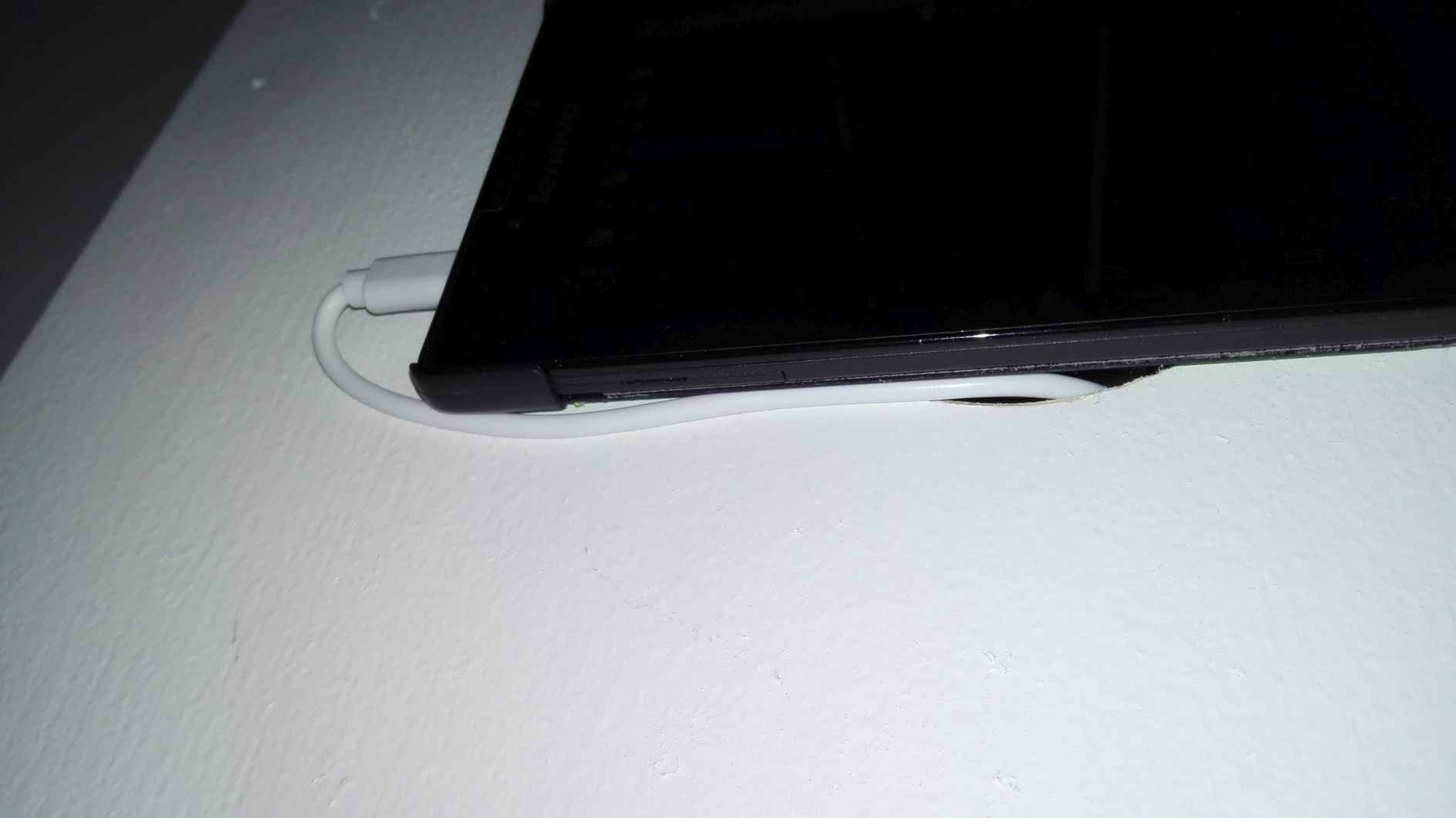

Finally the tablet was mounted above this using Hook and Loop Fasteners. As you see charging cable is almost invisible.

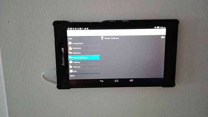

Sorry I have been on holidays, but when i get home tonight I will post some pictures of my instalation as well. What I did was that I ordered a case from china, cut away the cover. Then I just screwed the whole cover to the wall with two small wood screw. This way I can take the tablet off and bring it with me in case I need to.
I also installed an app called stay alive so that the screen is always on.. I use the classic UI, not sure what UI @Artyom_Syomushkin is using.

You could recreate my cable. It took me about 15 min to cut it from wireless charger and solder to usb connector. It pretty unvisible - just small golden piece is visible. And since it’s quite flat - you can put your tablet right over it - no need to route it from side.
Under wireless charger i meant this HW -perfect angle and size for connector. http://g03.a.alicdn.com/kf/HTB1HwvJJXXXXXaaXVXXq6xXFXXXO/Universal-Android-Phone-Qi-Wireless-Charger-Receiver-Card-for-5-Pin-Micro-USB-Port-2-Charging.jpg

I just slightly modify a case for it, then put two wood screw through it.Wanted a white case but could not find such a case for my lenovo. At the top the two magnets for the cover(I cut the cover off) can been seen.
