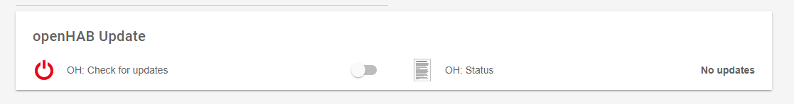

Screenshot

/items/update.items
Switch OH_CheckForUpdates "OH: Check for updates"
String OH_Status          "OH: Status [%s]"
sitemap
sitemap something {
  Frame label="openHAB Update" {
    Switch item=OH_CheckForUpdates
    Text item=OH_Status

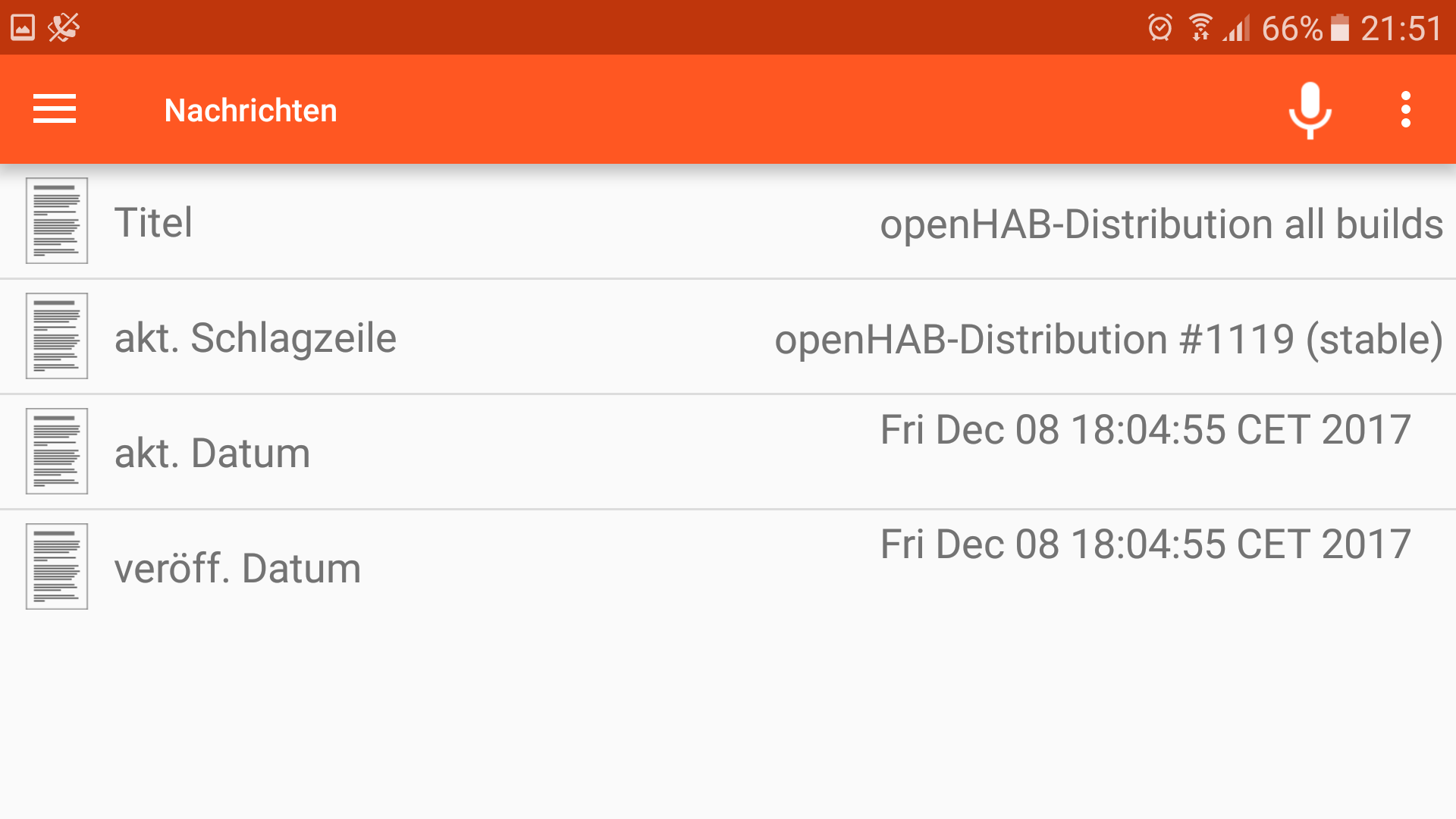

For this I simply use the feed binding.
Screenshot_20171208-215109
URL: https://openhab.ci.cloudbees.com/job/openHAB-Distribution/rssAll
.items
String cb_title                	"title"  				(News)	{channel="feed:feed:255f7361:title"}
String cb_latest_title   		"latest title"		    (News)	{channel="feed:feed:255f7361:latest-title"}
DateTime cb_latest_date        	"latest date"			(News)	{channel="feed:feed:255f7361:latest-date"}
DateTime cb_published_date 		"published date"		(News)	{channel="feed:feed:255f7361:last-update"}

what url did you provided for the feed binding?
@Melkor
.items:
