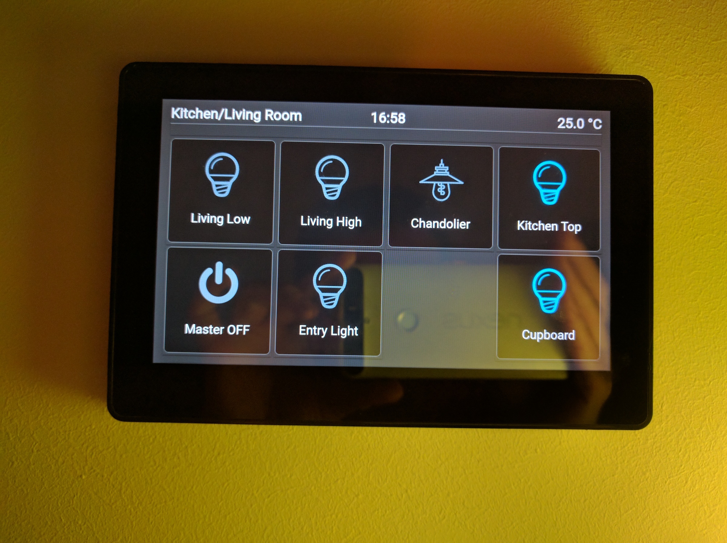

I have gone to do a thin template widget where I have a title of the panel a clock and a temp of the room.
I wish I could do it a little bit smaller but that is smallest possible height for a widget.
How to you manage to have te time and the temp on your status bar ?
There is a code for the clock statusbar in thermostat thread.
