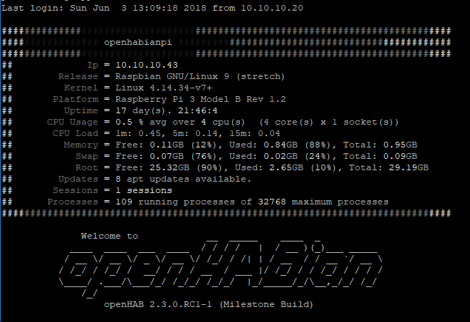

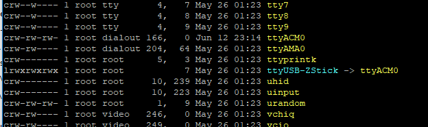

The USB stick is assigned to:
The system shows:

I always use the linked port via ttyUSB-ZStick → ttyACM0. In my first entry of the blog I added a hardcopy of this before I yesterday restarted my system (by the way: with this restart it switched to ttyACM1).
Are you using more than one usb stick on your RPi?
Then you may need to use symlinks (I would do that anyway because of your changing ports [which is not normal if using only one usb device btw]):
I only use one usb stick and yes I use symlinks (this is what I wanted to say with my previous entry).
So no need for symlinks :sunglasses:
Why did you do it? Somehow messed up your operating system??
Correct. This Serial port is initialized shows that the serial port is opened ok. Later, we then see the exception showing there was a write error, and the serial port is not working.
I would suggest to try the stick in another computer to try and rule out the stick, then maybe try another stick in the USB port, and maybe another serial stick if you have something… Basically trying to work out if it’s the USB, serial driver or dongle that is at fault.
Hi @sihui, I added the symlink for the usb stick, because my Pi sometimes assigns the ACM0, sometimes the ACM1. And exactly the article you referenced I used to add the symlink. Yesterday, when my zwave devices were all offline, the ACM0 was in use. After restarting only OpenHAB (not Pi) this night the ACM1 is in use. This is what I as Non-Linux-Freak can answer here :slight_smile:
Regards, Siggi
So you need to find that problem. It should have nothing to do with zwave, though :grinning:
