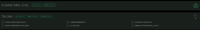

Thought I’d write a basic tutorial.

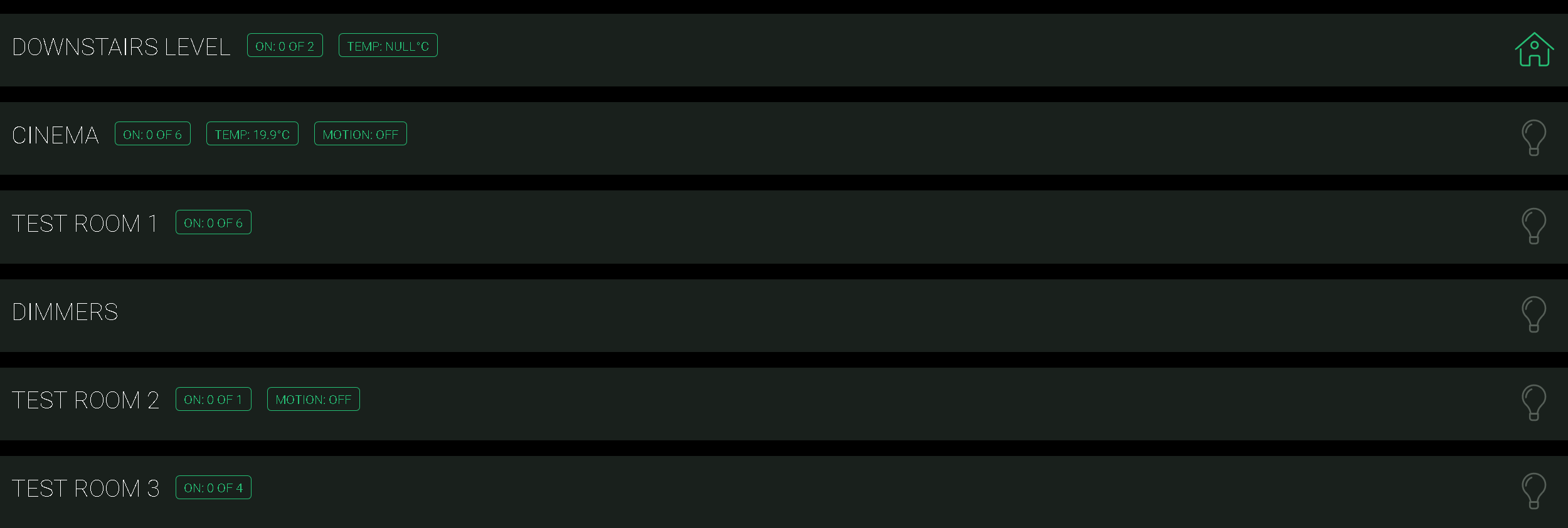

I’ve created some collapsible panes, which help break up a widget when you’ve got loads of items. For instance, I have a parent pane called ‘Living Level’, underneath this I have a number of rooms divided further by child panes, and below that all my items displayed via a group.
I’ve put my configuration into a text file for you.
lights.txt (77.4 KB)
Essentially, there are a few elements that are important
<div ng-init="collapseStudyShutters=true">
<div class="" ng-click="collapseStudyShutters = !collapseStudyShutters">
<div class="controls" ng-hide="collapseStudyShutters">
You can subsitute the names for something meaningful for you pane. This particular one is for shutters, if you create some items and groups, youll get the Study pane to expand out and show a few items.

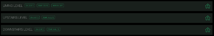

Building Level
Floor Level
Room Level
