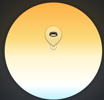

That is usable for HUE color lights but not for ambiant lights. I’m searching for something like HUE has.

Look at the screenshot from Hue above. Is is a kind of color picker but for ambient (color temperature) only.
There is nothing like that in openHAB. A Dimmer is a Dimmer and a Dimmer can be controlled with a slider, or a setpoint, or a switch or by sending a value between 0 and 100 through some custom widget. A Dimmer is not a Color and a Color picker widget cannot be used with a Dimmer.
