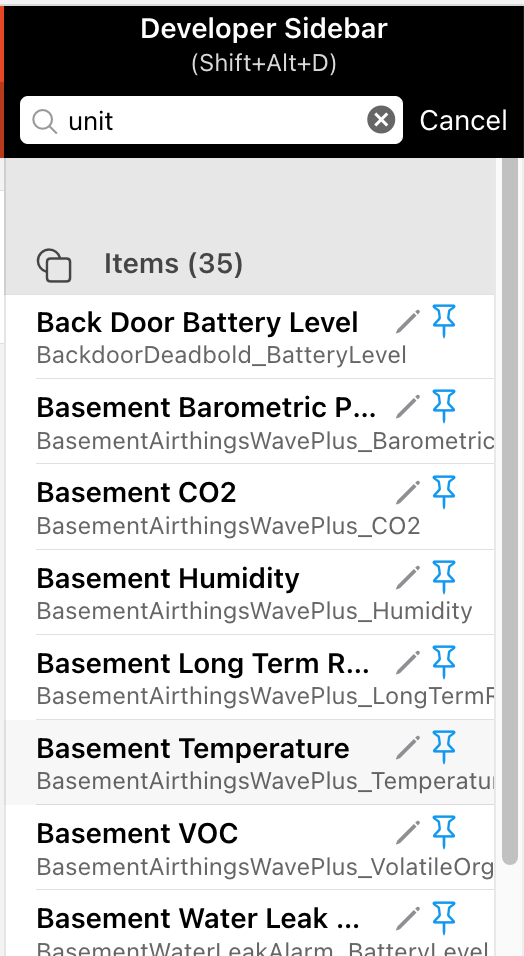

The Developer Sidebar includes searching inside Item metadata in OH 4.
that shows the top of those Items where I have unit metadata.

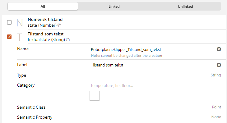

Just to be sure: Wouldn’t that be with default auto-generated item names? All things and items are generated with names and labels very far from the naming I would normally use, especially for localized bindings, since I use English (and conventions) for my naming. Example:
Lawnmower = Robotplæneklipper (Danish)
Thing name with Danish characters translated (æ → ae) and concatenated with full channel label (“Lawnmower” + “Textual State”):
This is really awful, but perhaps I’m missing some options where this behavior can be configured? I would name that item Indego_TextualState and leave the label as suggested.
See my previous reply, this won’t fully work. But to be fair, the process is partially automated for managed items and fully manual for unmanaged. For managed items you could also add unit metadata in advance to have a smooth upgrade to 4.0.
Can it also find all items of type Number:<dimension> without unit metadata, like my command? :slightly_smiling_face:
You can override all the settings for each Item individually if the defaults don’t work for you. Even in cases where I override everything, I find that page to be about as fast as defining them in text files.
Notice I said “create equipment from thing”. This part is important because this also creates the Equipment Group and the default names of the Items come from the name of that Group plus the Channel name.
So if you touch nothing, the name of the Equipment will be the same as the name of the Thing. But this is easily overrideable.
The names of the Items are generated from the name of the Equipment and the name of the Thing’s Channel it’s linked to.
Then change the name of the Equipment to “Indego”. If the use of “_” instead of camel case, you’ll have to edit the Item’s name to remove it.
If you use “add points to model” instead of creating the Equipment you can choose the already existing Equipment or Location. And then again, the Item name will be based on the selected Equipment’s or Location’s name and the Channel name.
In my experience, if you are going to use the semantic model at all, this is the only way to populate it with Items. It’s actually easier to recreate all your Items this way than it is to retrofit the semantic model to an existing set of Items either through text based configs or the UI.
I don’t know. I don’t know if the search is just a String or a regex. But you can search inside the JSONDB metadata file. This feature is brand new in OH 4 so I would expect it to get better over time. There is no reason why it can’t be made to support a search like that.
