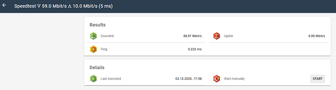

I don’t know if you are aware of this feature. But if you use the network binding, you can use a already existing feature “speed Test” as an own thing. So no need to write a script for this
I tried to run it within scripts/demo.sh without much success. I saw different tutorials for Speedtest i to openhab and it was working for other people, but maybe because I use docker and other people dont?
However thanks for answer. I will look into that topic.

So thinking about all these facts I think the easiests way is to use the network binding because this will not have any side efects on an openhab update (expecting that the binding itself is still working and has no bug on the new version of OH)
