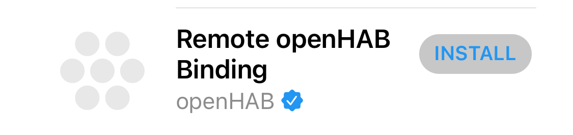

Thanks for the hints. I cannot find the OpenHab remote server binding in OH4. Is there any issue why it has not been upgraded to OH4 yet?

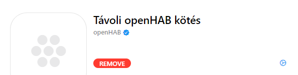

It is there :wink:

Ohh yeah, just my instance translated to Hungarian :crazy_face:
