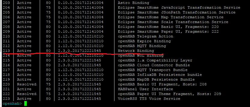

As an option, have you tried clearing the cache and temp?
After you set the binding, do you see it in the karaf?
ssh -p8101 openhab@localhost
bundle:list
Yes, I clear the tmp and cache folder and restart the service, uninstall the network binding and install it again, the network binding show in “bundle:list”, and still have
“[org.openhab.binding.network] - Component descriptor entry ‘OSGI-INF/*.xml’ not found.”
then I try to set “network:pingdevice:iMac_State [ hostname=“192.168.0.6” ]” in the “things” file, but still not work.
may be I need to reinstall openhab2 and whole addon, but I don’t want to setting it up again.
so I’m give up use “network binding”, and use “Network Health Binding” now.
thanks your help.
