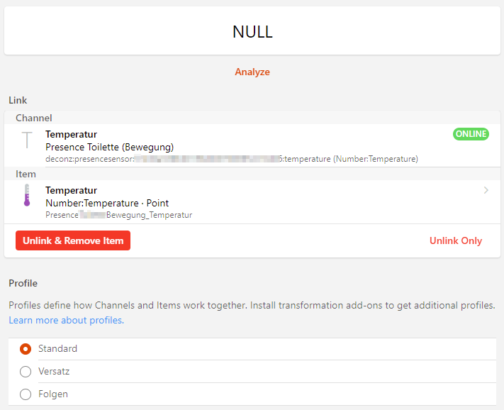

I integrated mostly successful an Aqara motion sensor. I can receice the presence and Illuminance channels. However I cannot read the battery leval and temperate value from config. Those values are always NULL (and I waited several hours until the sensor temperature changed in the Phoscon app.

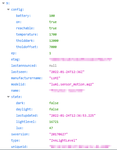

Here is a manual API from /api/$key/sensors except for the sensor:
As already described the temperature isn’t read.
The log showed nothing helpful.
How can I investigate any further?

About the possibilty of the missing attributes: Those attributes are available in the phoscon app and also shown within the Rest API.
