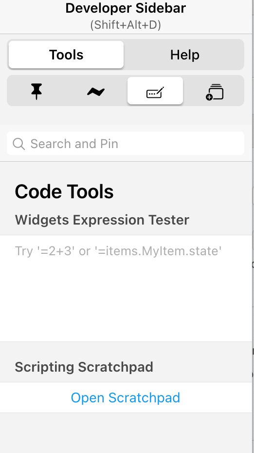

That most likely means that @@number_openhaboperatingmodus_dayphase is just not returning the data you are expecting. This is where the expression tester is so important. Put =@@number_openhaboperatingmodus_dayphase into the tester and see what it shows you is the actual output.
