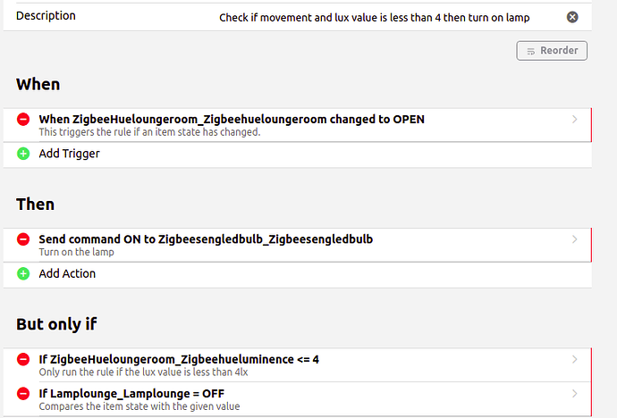

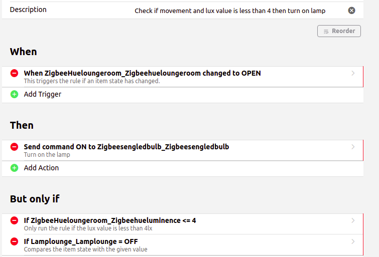

I have Phillips Hue sensors for light readings:
The rule is if motion is detected and the lux is less than 4 and the Lamp in the lounge room is off then turn on the small lamp which has the expire set on it.
I have the check fro the lounge light is off because it is dimmable and can get below 4 lux.
